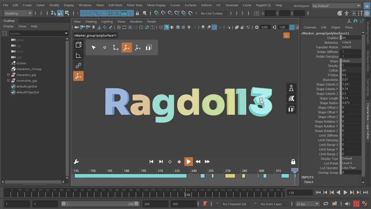

Here are some comments, it might be a long post I will break step by step so you can have the clear input and see where my intuition took me. " I think I am lost and using it the wrong way will need more Documentation or Demo "
Having basic ragdoll/ 5 joints FK hierarchy
1- select marker, Ragdoll GRP or rSolver and press “T” to enter Live Mode/
2 - Select the last option to activate Live mode
3- 3- Select and use any of the three option to Interact with the Ragdoll “Pitch -Translat - FK or IK” . These otions will activate activate the /playback simulation . Or will save on “cache” the modifications made to the Ragdoll”
Until Here… I guess I survived …! XD
Note:
    1. A- I found non-intuitive having to use “select” to stop the running SIM/cache
Is there any other way to stop Time Line? … would be good to know
the fact that there an Icon of Play, mu User Brain is trying to find the “Stop”
    1. B- “W” helps to reset, but if we use it and while we get use to it , Will we loose the “motion cached”?
4 - “toggle” this option happens so fast on the documentation that took me several rounds to figured it out. Maybe I was not familiar with the “toggle” … but then I got it…
5 - To stop the running Interaction / Time Line “live mode” use the “Select”arrow
6 - Now that I had some motions that I like, I thought that by using ragdoll/ “record simulation” will save/bake my keys. Until I figured first “cache” the motion
7- Press “Q - W -E or R” to exit the Interactive mode,
8- Check that the Motion was cached successfully and do ragDoll / Record Simulation
… Until here… not sure if this is the right way to Do it… But I was able to “record the animation”

Thanks for this @Andrei_da_02!
This doesn’t sound right. Playback should not start. Can you confirm this is what you are seeing? If not, can you record what you see?
https://user-images.githubusercontent.com/2152766/206457499-2b1896f3-e476-4082-b90b-9aecc877fdd2.mp4
I assume you have either Drop of Tense active, which would include playback. If so, I can confirm that it pauses when using the Select manipulator. It should not pause playback, that’s a bug I can address.
Yes, I haven’t figured out how else to make this sensible.
  1. If you exit the Manipulator, and keep the current state including cache, what should happen when you playback in Maya?
  2. If we separate between the simulation inside and outside of the Manipulator, such that when you re-enter the Manipulator you get back to the cache you had when you exited, what if you wanted to reset it?
When you re-enter the Manipulator and want that cache to remain, what is it that you wanted to do? What is it in the cache you need? It’s only really meant for undo/redo and to rewind in Live Mode, what else would you like to use it for?
I’m not sure how to make it more clear, there’s a tooltip. Any idea on how this could be made more clear?
Yes, working on this. The current release is only intended to pose; the ability to record is up next, and the cache method is a temporary hack you can use to record early.
It’ll do the same thing, except not set a keyframe.
Yes, it’s the same solver, the same settings. Live Mode disables Gravity and the stiffness between Markers and increases Air Density, unless you use the Drop and Tense buttons. Everything else is preserved, such that you get the same result in both Live Mode and vanilla Maya playback.
