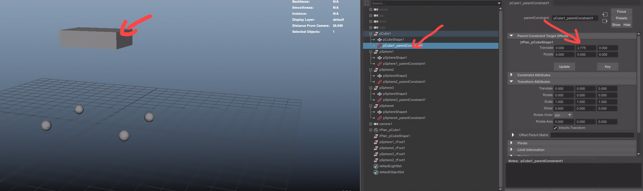

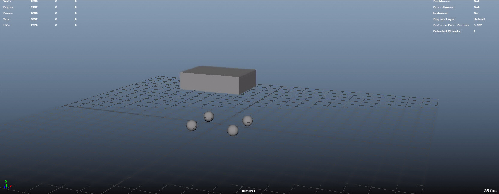

This is my start setup:

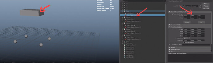

When i assign a plan it looks like this (all objects have an offset):
I can see the offsets when i click on the geo (cube and spheres) and select the parent contraint.
Then i can see the offsets in there:
I can reset the offsets to 0 and then it looks good.
But why is he adding the offsets when i assign a plan?

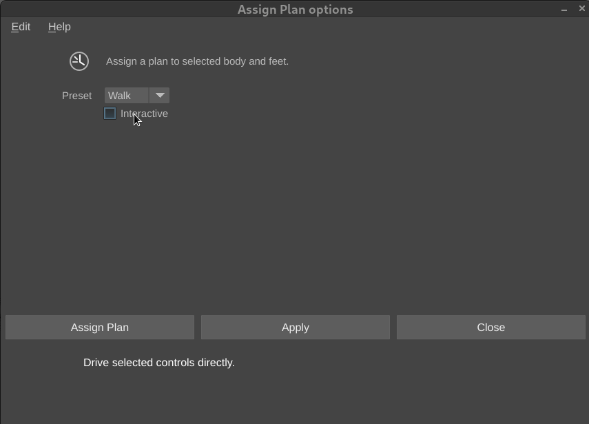

Ah okay, I believe the problem was this. You had that Interactive enabled when “Assign Plan”.
That should also explain why those empty groups were created, in this thread :point_down:
Please have another try with that Interactive disabled, and see if that works.
Thanks!
Thanks for your respond.
Uncheck “Interactive” is the solution.

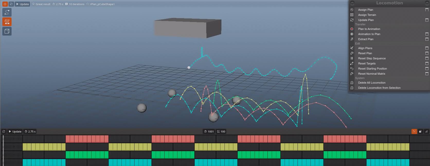

But normally i want so see it interactive to check how my Character really behaves.
So even if i would use locators (no freeze) for my rig i would´nt be able to see it interactive.
Or do i get something wrong?
Hey @alesch ,
We have a fix for the Interactive mode, please give this a try. Thanks.
Thanks for the release.
Now it works :slight_smile:
