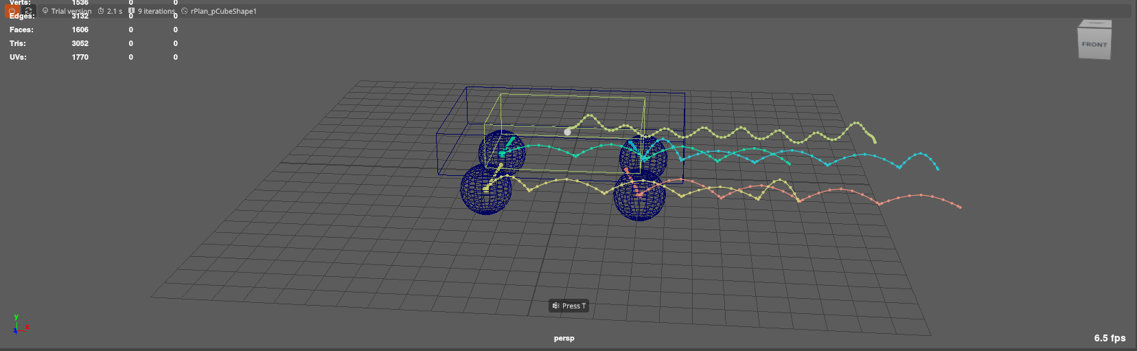

OKAY WOW!
So I removed the RAGDOLL_FLOATING from the environment and then loaded the plugin. It immediately asked for an activation.
When I applied the key I received a timeout error that made it seem as if it had not worked. But when I assigned a plan to a cube and four spheres, it processed for a moment and created a plan!
For the first time I saw the lines, that have only been straight, indicating a walk cycle. And I was able to transfer animation.

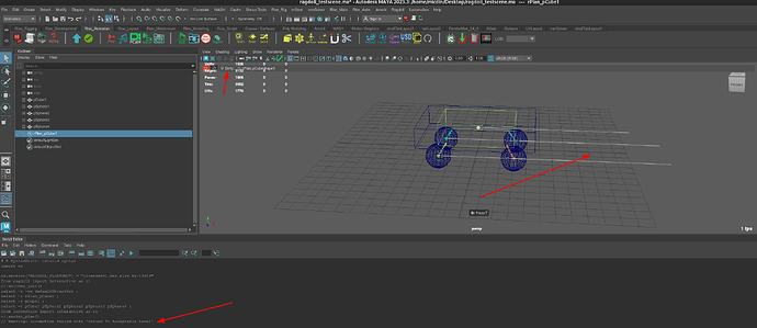

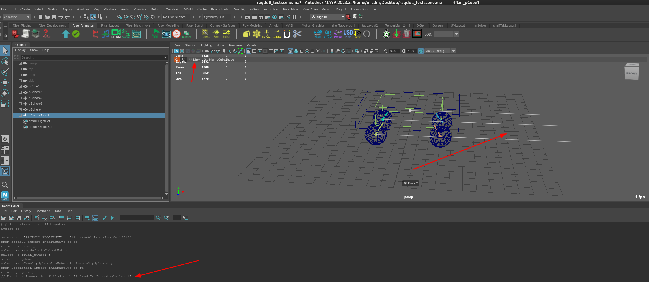

We are having the same problem right now. We have a floating license server with two licenses and ragdoll is able to check out the license.
When trying to run “Assign Plan” on a very simple test scene, it does not work and gives us the same warning message
“Locomotion failed with Solved to Acceptable Level”
If I then remove the RAGDOLL_FLOATING from my environment in Maya, it works again, but with a trial license. I made sure that loco3d has the proper permissions.
With env var
Without env var:

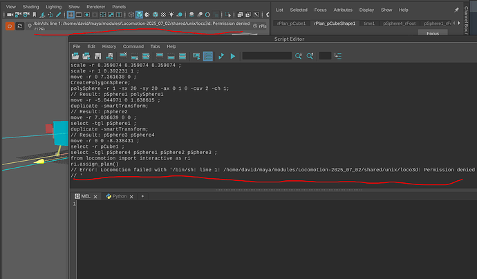

Thanks for reporting this, we are investigating as we speak and will return to you (both) in this thread.
(I also spotted that you email just now, will reply there as well)
Hi @micdin , sorry for the trouble and thanks for reaching out!
Now we have got a new quick release, this might not resolve the issue but should give us more clue.
Please download one of them, and give it a try. Please let us know if any error message shows up.
Thank you.
No I don’t see any additional error messages. Do I need to set a log level somewhere? The result is exactly the same as before
Hey @micdin,
That’s strange :thinking:

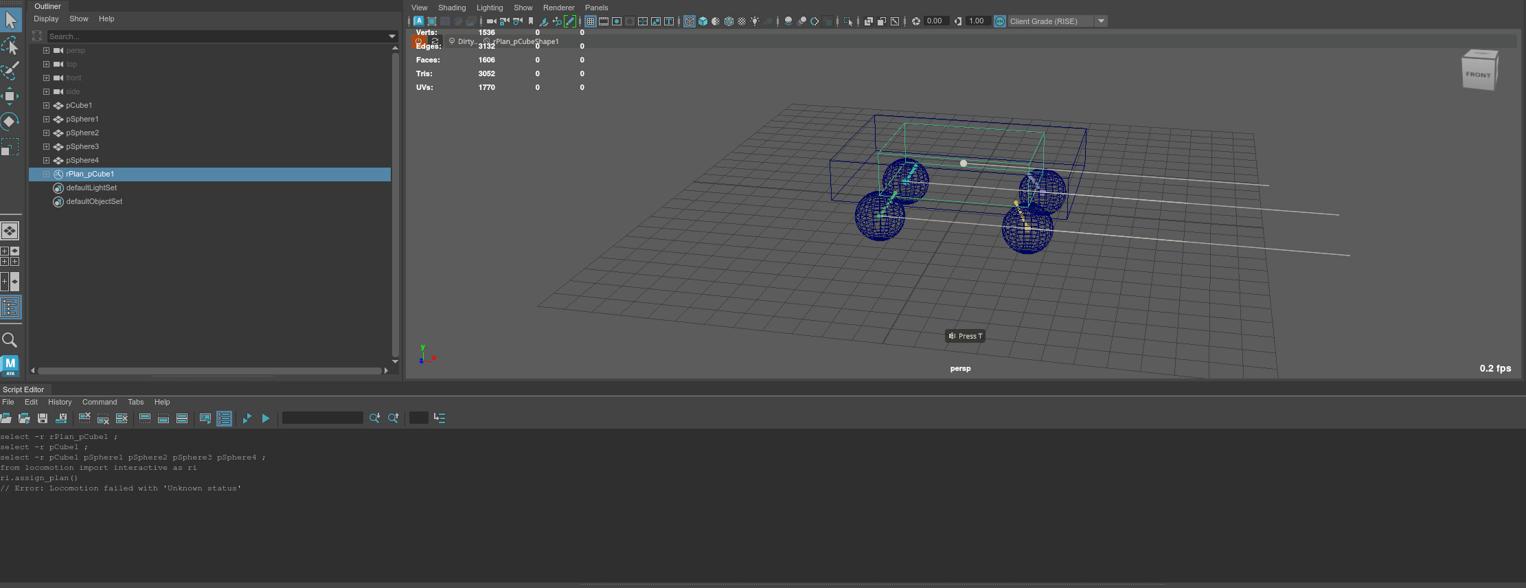

Can you share your Script Editor screenshot?

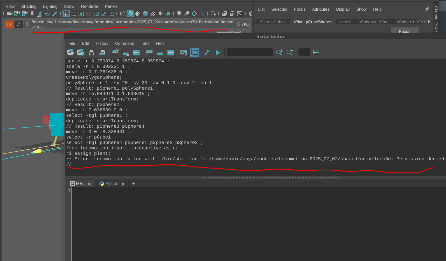

From the screenshot you have posted above, there was this warning/error message:
Locomotion failed with 'Solved To Acceptable Level'
Which was actually a bad message and did not tell us the true cause. And the new version should show us more on that.

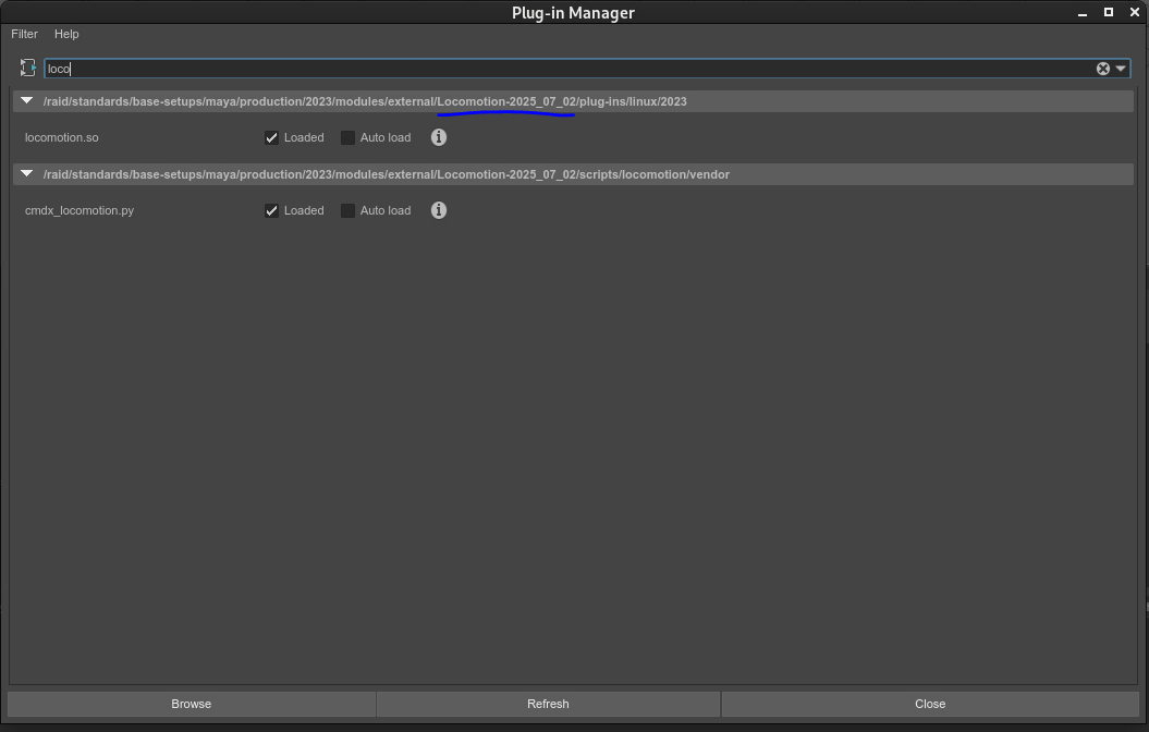

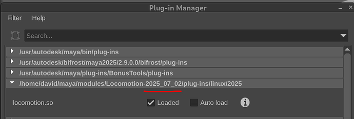

Can you have a look? Also, just to make sure, can you also share the screenshot of your plug-in manager window so that we know it was the latest version of locomotion?
In the mean time, I will also double check on my Linux box.
Thank you. :slight_smile:

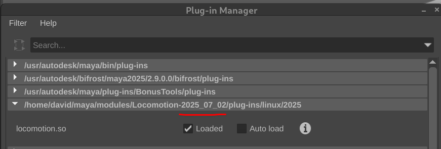

@micdin If you have installed correctly, this is what you should see in your Maya Plug-in Manager window.
Then with licence applied, instead of getting that “Locomotion failed with…” warning, it should raise error instead.
For example, this is what I got from a fresh install.
Thanks!

You are correct, the error message did change after all. It not says
Locomotion failed with unknown status
I also can not see anything in the terminal
I’m sorry, the last post was a mishap by me. We have two licenses available. One is being used by me for testing and one by an artist.
I now made sure that we have two licenses for me available. After that, I do get a different error message
I hope that helps
