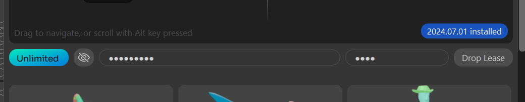

Ragdoll: Trial expired
Even tho we have 3 current unlimited lics that show up correctly in Ragdoll

Yeah I can confirm that Radoll has a full unlimited lic and when I either make a simple scene of a cube and spheres or load the scene that was mentioned earlier in the thread I get the error in locomotion.
