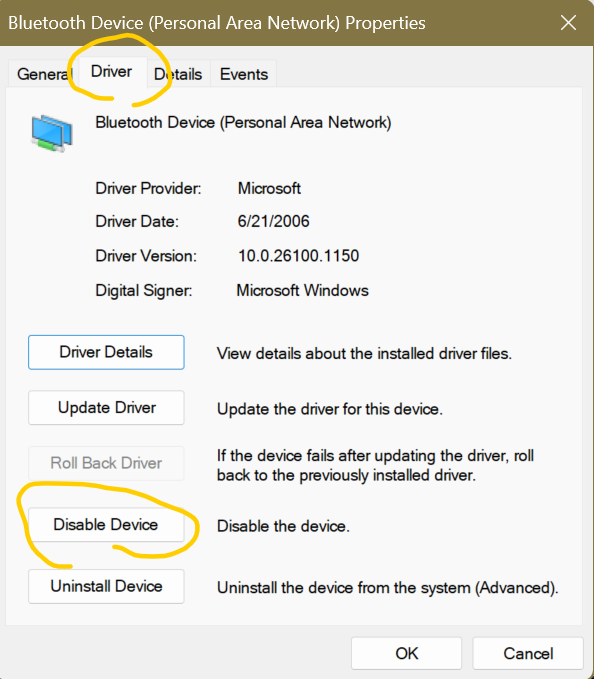

Option 2 - Deep Dive
To ensure you re-installed and/or disabled the network driver in question, try running this command from a PowerShell window and confirm you recognise them.
Get-NetAdapter
It should print out something like this.
Name                      InterfaceDescription                    ifIndex Status       MacAddress             LinkSpeed
Ethernet                  Marvell 10G Ethernet connection              23 Not Present  D4-5D-64-53-99-D7          0 bps
Ethernet 2                Intel(R) I211 Gigabit Network Connecti…      22 Not Present  D4-5D-64-53-99-D6          0 bps
Bluetooth Network Connec… Bluetooth Device (Personal Area Networ…      17 Disconnected 4C-1D-96-70-F1-A6         3 Mbps
WiFi                      Intel(R) Wi-Fi 6 AX200 160MHz                15 Up           4C-1D-96-70-F1-A2     144.4 Mbps
vEthernet (WSL)           Hyper-V Virtual Ethernet Adapter #2          50 Up           00-15-5D-56-AE-B8        10 Gbps
vEthernet (WiFi)          Hyper-V Virtual Ethernet Adapter             44 Up           00-15-5D-C8-81-49        10 Gbps
You can ignore anything virtual and anything Bluetooth. In my case, there are 3 adapters, Marvell, Intel(R) I211 and Intel(R) Wi-Fi. I would ensure these are all enabled.
Let me know how you get along, and we’ll take it from there.

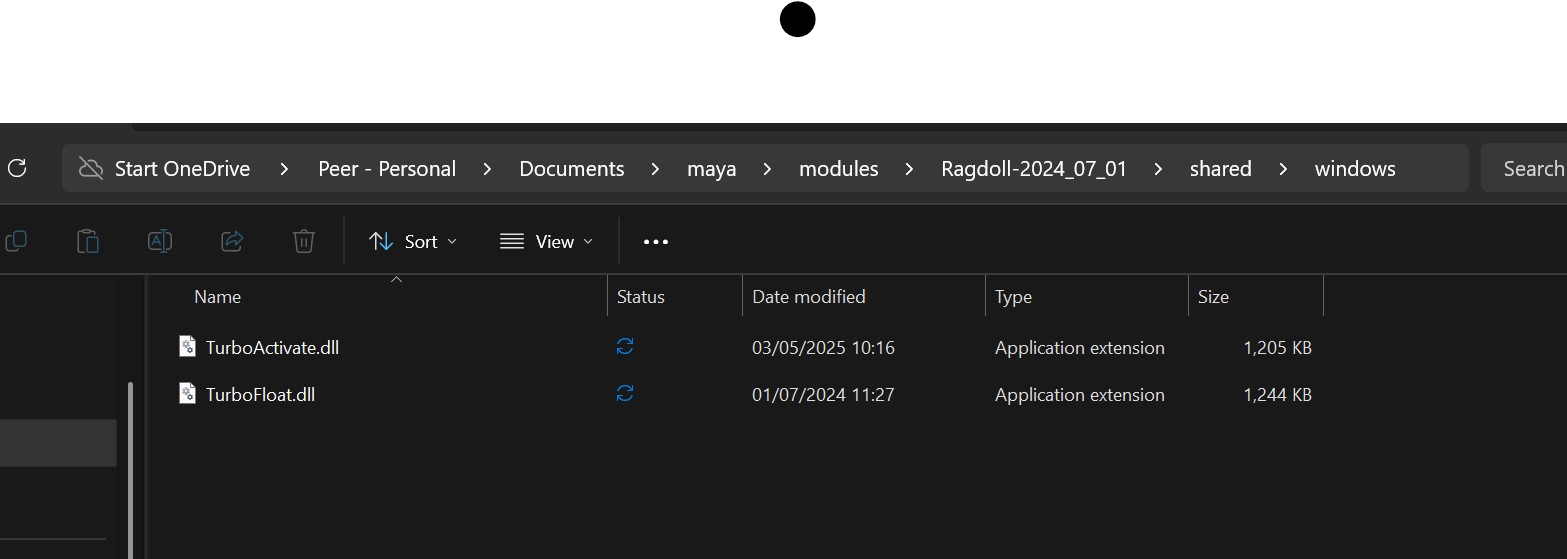

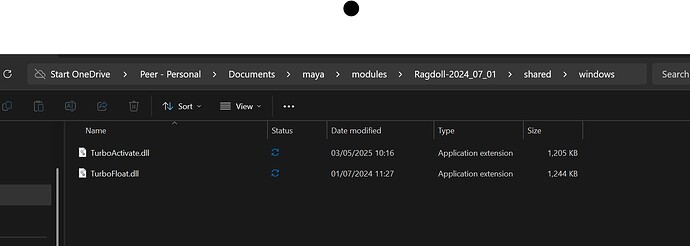

  1. Go to the Ragdoll installation folder
  2. Check the size of the TurboActivate.dll, it should be 1,205 KB
Can you post a screenshot like this too?

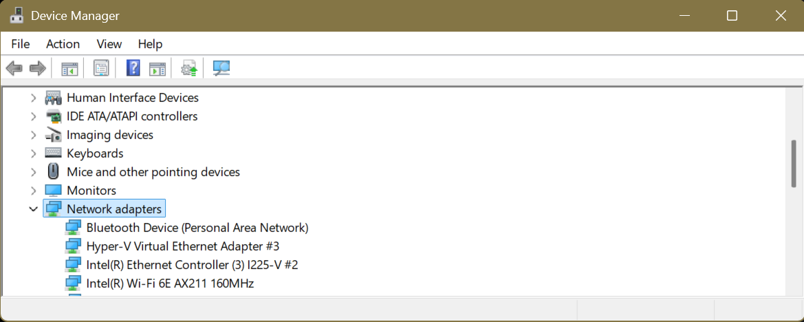

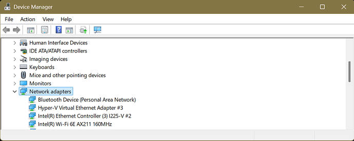

Great, this definitely does looks suspicious. Unless you have a single Wi-Fi card capable of connecting to 5 networks at a time, or 5 individual Wi-Fi cards in your system, then this appears to be the problem.
The licencing mechanism uses your hardware to generate a unique ID for the licence registration. If there are devices that cannot provide an ID, it refuses to work.
So, unless those are legitimate devices that you recognise, we need to rid ourselves of them.
  1. Download drivers for the Killer(R) Wi-Fi 6E AX1690i
It’s important to do this first, since the next step will disconnect you from the internet.
And then:
  1. Press the Start button once more
  2. Type “Device Manager”
  3. Open “Network Adapters”
  4. Right-click and “Uninstall device” on the Killer(R) Wi-Fi 6E AX1690i device(s)
  5. Reboot
Once booted back up, Windows should re-install the drivers for them, but it’s possible it does not, which is where your drivers come in handy.
To confirm that it worked, type Get-NetAdapter once more, and it should only list 1 Killer Wi-Fi device.

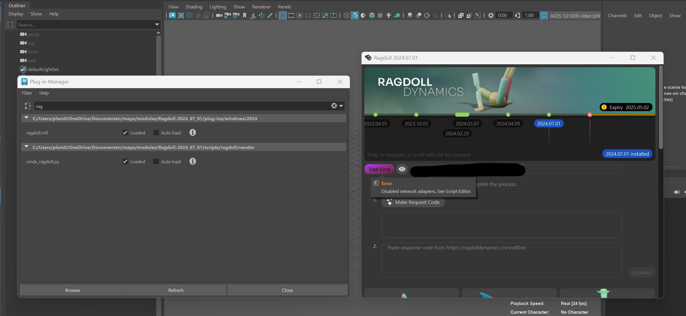

hi, im on windows 11, maya 24.2 - i went through all the above steps. still doesnt work for me… copied the dll… reset the network drivers… made sure theyre all eneabled… i still get the same error being :

Thanks @plem73 , and welcome to the forum!
Just to make sure, the DLL you have replaced is under:
C:/Users/plem0/OneDrive/Documents/maya/modules/Ragdoll-2024_07_01/shared/windows
Is that correct? Also can you check the file size for me? A screenshot of that DLL folder would be the best.
Thanks.
C:\Users\plem0\OneDrive\Documenten\maya\modules\Ragdoll-2024_07_01\shared\windows

Hey @plem73
Thanks for the screenshot, the file looks right. Hard to say if it was OneDrive, but you did jump through a lots of hoops!
It looks like you have already deactivated the file sync? At lease to the path from your screenshot.
As for file locations, it does not matter where you install them as long as Maya can find that Ragdoll-2024_07_01.mod file and the Ragdoll-2024_07_01 folder next to it.
Here’s another thing you can check, from our licencing provider (link):
  1. Type “Device Manager” in Start Menu and run it.
  2. Open the “Network adapters” branch, like so:
  3. Then, double click on the first one, should open a pop up window like the image shown below, and go to the “Driver” page, and see the buttons below:
  4. You should see “Disable Device” button if that adapter is enabled. And if you see “Enable Device”, bingo! You found the cause.
  5. Repeat step 3 and 4 on every signle netwrok adapter you see in there.
Edit: I know you have been through this network adapter checking thing, but the “Device Manager” seems able to provide an interface that is easier to work with, and more complete info. So please bare with us. :slight_smile:
hey, thanks again :slight_smile:
unfortunately i have no errors there at all and all in enabled.
welp i got it to work!
solution was…
uninstall wifi all together… use cabled network only - ethernet.
so went to uninstall wifi device under device manager, only had my single ethernet running as im cabled on to internet anyway this worked for me.
go figure
Only issue is, as soon as the wifi device is added back the license messes up again… maybe you need to adjust how the license works because why not keep using my ethernet network for cabled internet connenction?
