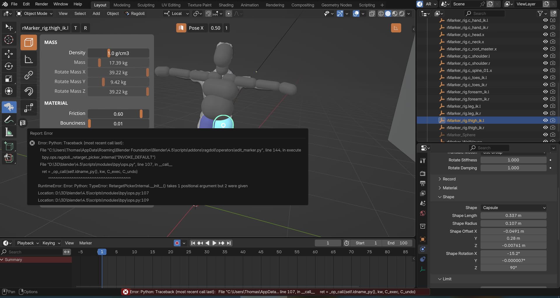

thank your for your beta links. I got it to work somehow, but it’s very buggy. Selecting a marker and do a retargeting through the menu still throws an error (bug.png).
It just works, if you go in pose mode, select the pole and use the retarget button inside the solver/target window. But here is an other bug. Often it works just once, so you have to switch back to object mode, when back to pose mode, select the pole it can can be retargeted. But you can not simply select all poles one by one in pose mode and retarget, as the retarget button does not get enabled again if you select the next marker. You always have to switch to object mode and back to pose mode.
