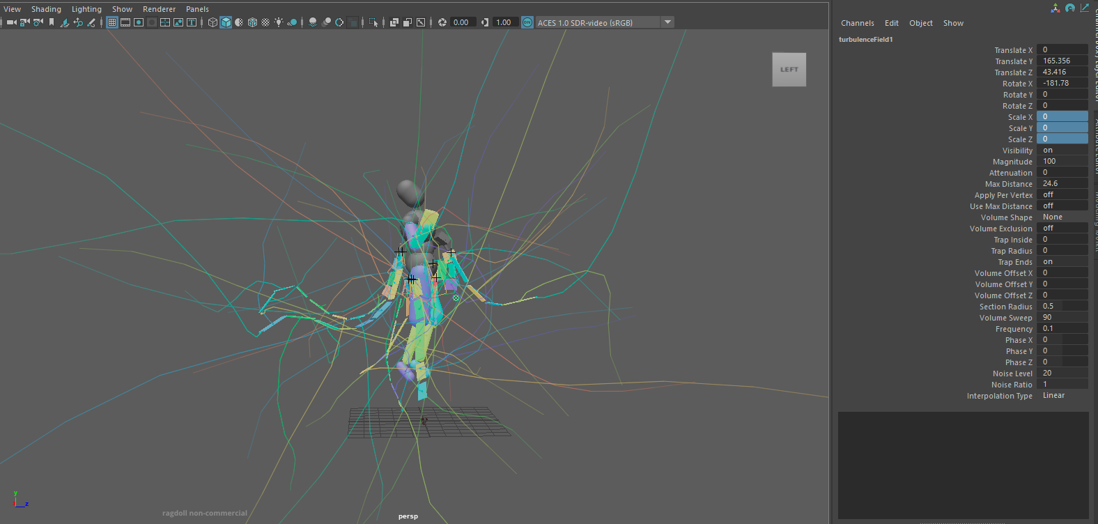

Sure, here’s an example of Air + Turbulence.
Notice how they are added together, the air pushing the turbulence in one direction.
