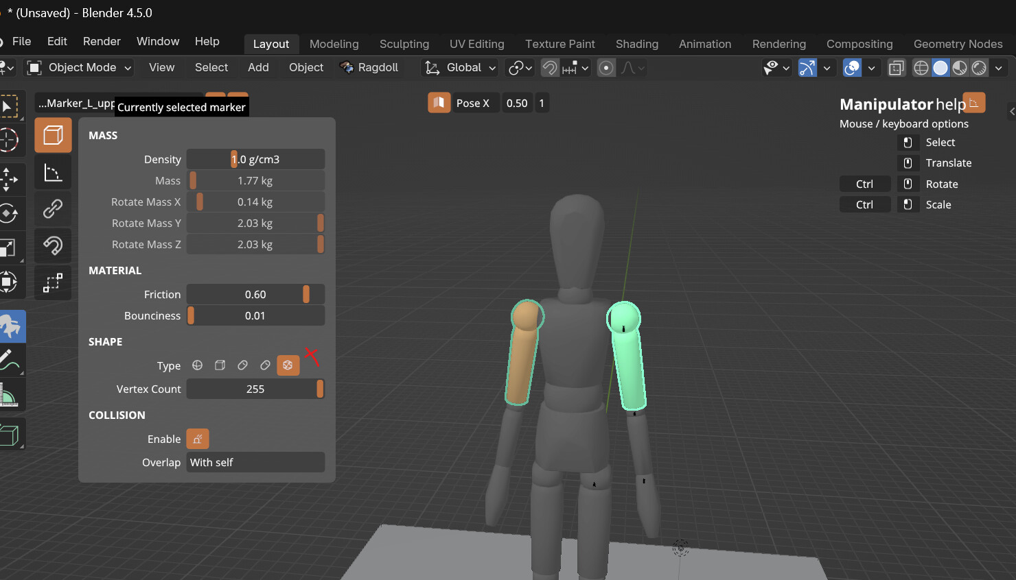

Another case is that if a marker is set to mesh shape, like image below, then it can not be transformed.
Hope these help!
