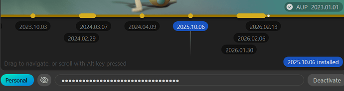

Hello. I have trouble installing ragdoll for m2026.
I think the download page or the terminology is misleading. e.g above the download buttons it says: Autodesk Maya 2019 to 2026
Below that buttons it says Ragdoll 2025.10.06 awaits. Misleading because I reference the 2025 here to the maya version. And when you click it to read more about you land here: Beyond Ragdoll - Learn Ragdoll
I downloaded the msi- but the installer didn’t finished. Trying to re-execute results in just a short flash of the installer window. I’ll try again with a fresh reboot tomorrow.(Oh I am on win11)
I downloaded the zip like in the description, unzipped it and loaded the plugin maya.
The greyed 2026-versions( browser won’t open them). Is it that the 2026-versions corresponds to the new ragdoll 4?

Hi @martin, welcome to the forums. :partying_face:
Thanks for reporting these.
True, I also got confused for a moment, but then realised that those are the latest release notes for this version. The later versions have been minor patches that did not receive a dedicated release page.
The later releases relate to Blender and the new Ragdoll 4 early access.
That should flash is all you need. :slight_smile: Granted, it isn’t very descriptive on its progress or completion, it simply finishes too fast to notice. There should be no reboot needed, only Maya needs a restart to pick up the new module.
Yes, thank you, we spotted this as well. They do not account for the maya/ prefix of the versions since we started doing Blender releases. We will address that shortly.
