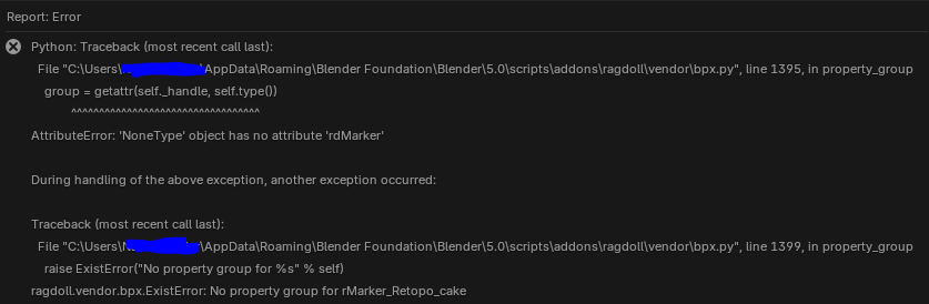

so, ive been having an issue where for whatever reason, when i delete a marker and reload my file, i get this error
ive had this issue once before and just deleted all physics and redid my markers, but im wondering if theres another fix so i dont have to assign everything again. if you need any more info, please let me know! thanks
was able to work around by exporting physics, deleting all physics, then re importing but a larger fix would be great

Can you tell us a bit more about how did you delete a marker?
Was it done by selecting the marker object in Outliner and then press X to delete, or it was done by Ragdoll menu’s System > Delete Phyiscs from Selection?
Thanks!
sorry, its sometimes hard to keep up with forums, i selected it with the ragdoll tool then clicked x
i think it happens when you delete a marker whilst not at frame 0/1
David is off today, he’ll get back to you on this tomorrow. But the start frame is generally special and the safest place to add/remove Markers. What should happen when you delete elsewhere is that it remembers this action and applies it at the start frame once you return, but it does get complex so I’m not surprised it can sometimes struggle.
makes sense, i will try and avoid deleting it like that from now on, thank you
