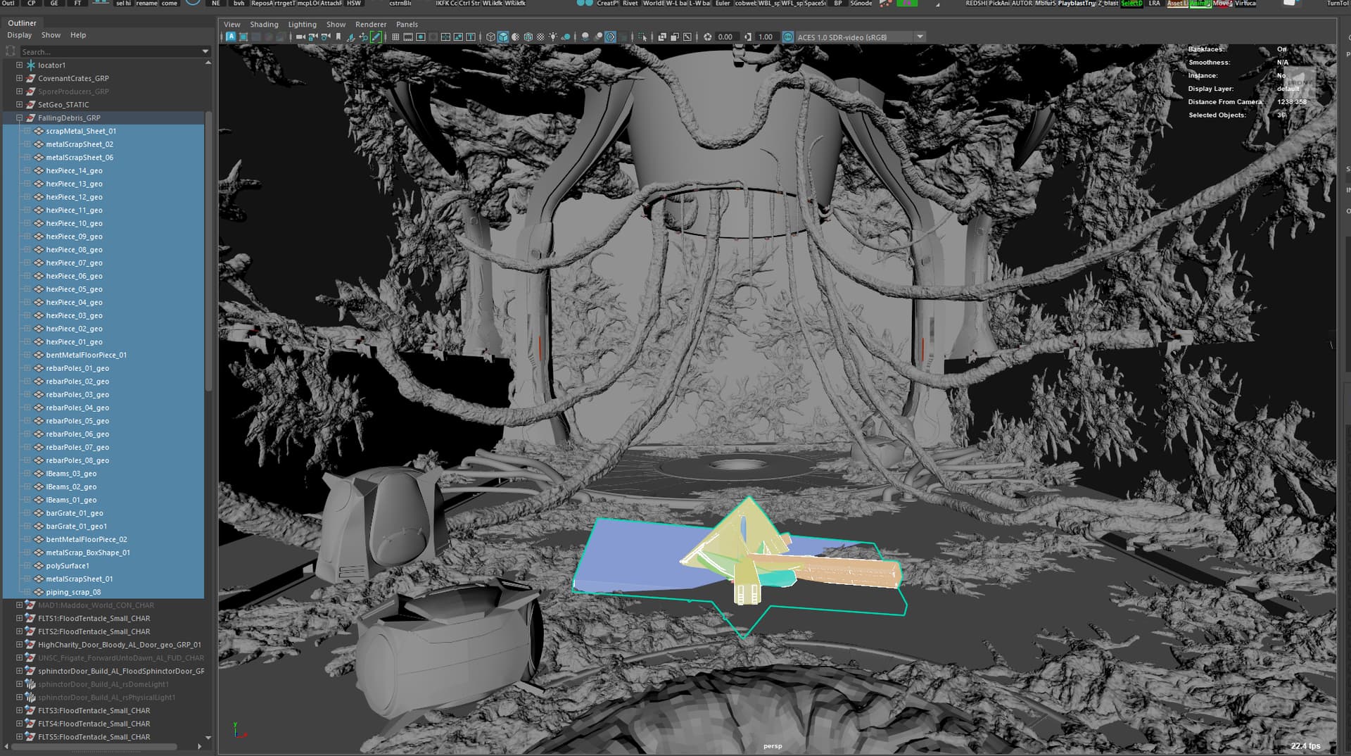

- Selected the geo and went to ‘assign and connect’ for the geo, then changed the collision shape to ‘mesh’ for better interactions.

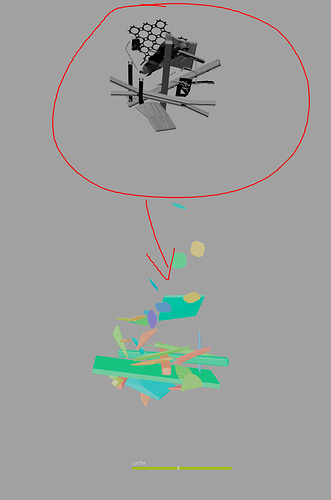

This is after recording, the actual geo stays where it was, but the simmed geo is still doing what i want it to. Any ideas how i can get the actual geo to match the ‘simmed’ geo?

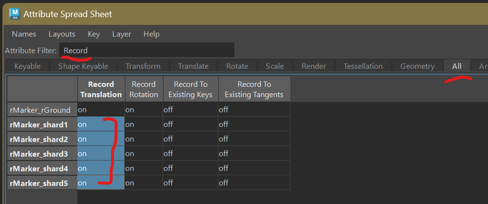

I noticed that you were using “Assign and Connect” when assigning markers, which is mostly for something that are chained, like joints. And in that case, only object that has root marker assigned gets translation from recording, child objects then inherits root’s translation and only rotation was recorded to them from markers.
So I am guessing those debris meshes are not moving because of that. Select one of those meshes, go to its marker attribute tab and have a look at Record panel, see if “Record Translation” is off.

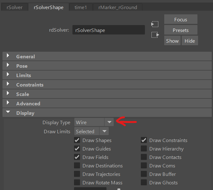

And, if you change solver’s Display Type to Wire, you should see one of those debris mesh is actually moving in recording playback, because it has root marker assigned.

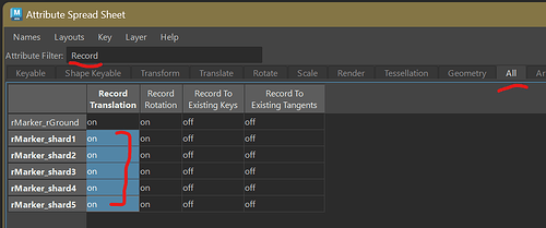

If when I am guessing is correct, this can be fixed easily by
- Go to Ragdoll menu → Select → Markers
- Maya Windows menu → General Editors → Attribute Spread Sheet
- Turn all those “Record Translation” back on.

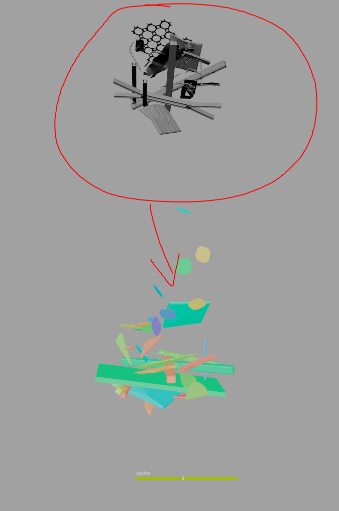

I did some digging and found the ‘record translation’ attribute and wrote quick script to turn them all on for the markers, however it ‘did’ record it but it just exploded the original geo (and doesn’t follow at all what the simmed geo was doing). Is this caused because of the assign / connect’ thing you’re talking about?
So from where they originally were, after recording they’re now here (the wrong position). And just sim going through the floor before exploding
I’m putting my scene scale to 1 here too, not sure if this causes issues?
No, it should not.
From the screenshot you took, it looks like the debris geo are matching the transformation of simulation?

Oh, did you mean those geo are not reset back to where they were?
Perhaps you have to check your Animation Layer Editor, Ragdoll records keyframes into animation layers.
If you delete it or mute it, those geo should be right back where they were.

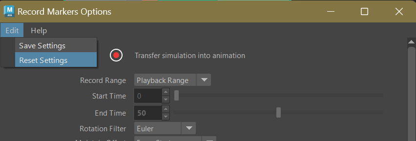

Hmmm… Have you tried reset recording options?
By the way, solver cache does not have to start from 1 though. Let value be 0 (Off) as default is fine.
OMG yes, this was it. Thats so strange!
Thank you so much!
