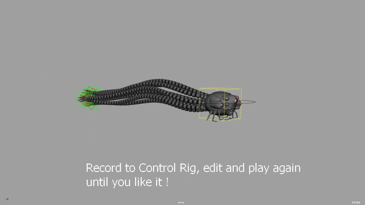

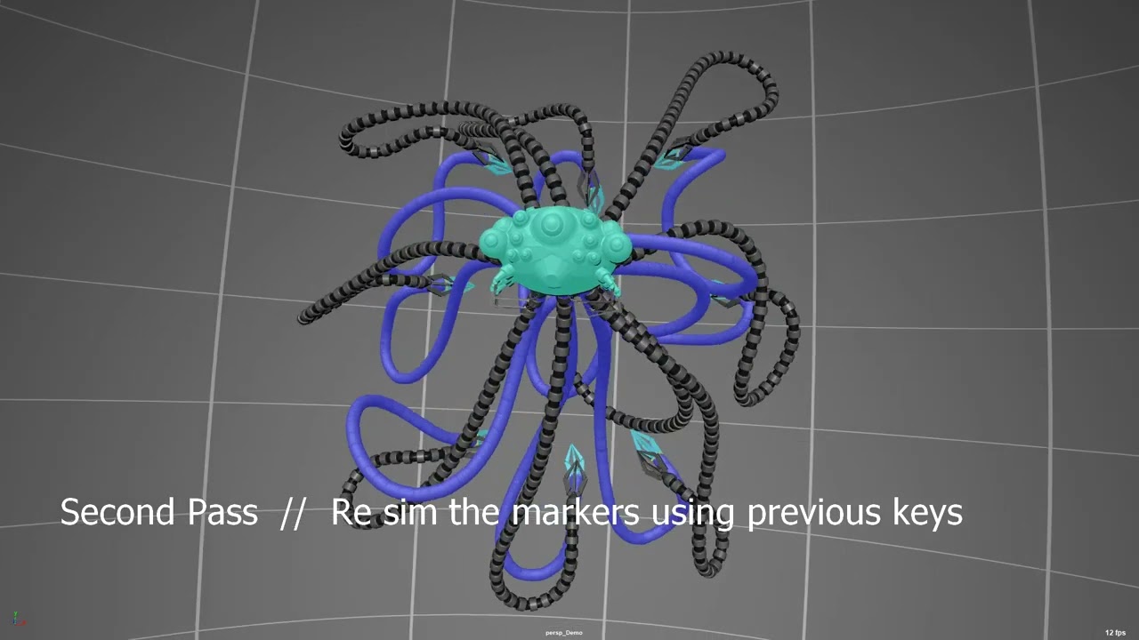

I’ve tried to come up with things to feedback on, but it’s tricky when the videos are of just the final result. It’s not clear how you arrived at the result or if there were any challenges along the way. Without that, it all looks like smooth sailing, for which I can only say “keep it up!”
The surrounding rig also looks too intricate to feedback on and outside the scope of Ragdoll. But it would be interesting to learn how you dealt with what looks like Spline IK controls for the tentacles and recording onto those? That’s a typical challenge with Ragdoll and one that takes some amount of finess and compromise.
I also expect you’d see more eyeballs and feedback if you cross-linked from LinkedIn/YouTube to the forums; as you’d otherwise limit the comments here to folk already present.
Hey Marcus, thanks for the coments and notes.
Yes, simple Spline IK and record into those.
So far I have been able to refine whay I need with the Markerts ad the Control Rig I created, but for that challenge of dealing with the keys of the SIM and bake it into control, is that I develped the Rope tool prototype. Still in progress but that kind of shows the idea behind.
