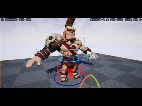

As for python and blueprints you don’t have to copy and paste. You can create an empty blueprint and select it and import python into that blueprint. AdvancedSkeleton has a decent example of creating a control rig this way.

Oh… yes! That workflow looks quite comfortable, I was not aware of this! Here’s hoping it can create more than control-rig specific things, primarily the physics nodes. I will investigate this. Thanks for this!

I did quickly investigate this Advanced Skeleton route, but it looks like this workflow is strictly limited to Control Rig, and can’t actually author anything other than Control Rig things, such as rigid body nodes or blueprints in general. :frowning:
