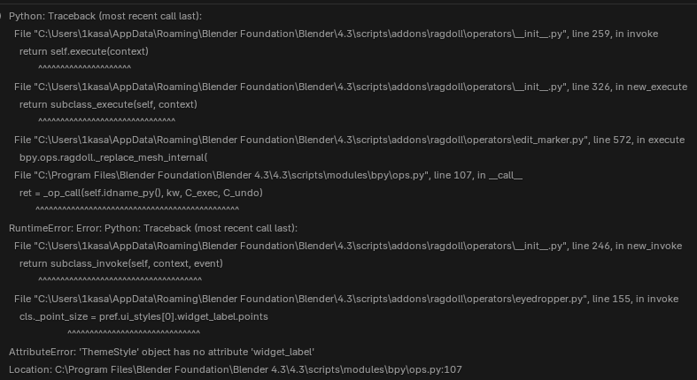

Error when trying to replace the mesh for the marker in blender 4.3
in 4.1 on the same project everything works
Thanks for reporting this @zeroInstance, we haven’t spotted this ourselves and will investigate. Will keep you posted in this thread.
Hi @zeroInstance, we’ve identified and crushed the bug. New download link will appear on the website soon, and until then you can find it here.
There will be no need to update Ragdoll Core for this one, only the Blender addon. Let us know how it goes!
@alanjfs
Everything works now, thank you)
