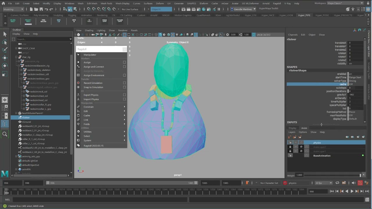

Hey Ragdoll team. I have a file that is bare bones. And still has the problem. Only nodes required for the sim. all unknown plugins removed. Nothing appears in the Output window. Here is the script editor, et al.

I think you may want to remove the vidcap. it shows your license number… ![]()
trying now.
Thanks for the concern, but the number is also in the docs.
