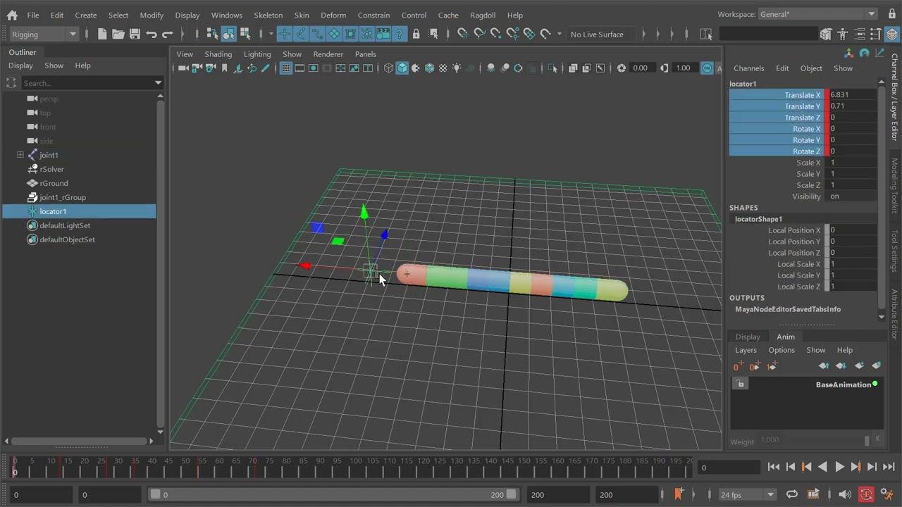

let’s say I have the markers “riding a curve” driven by a curve using motionPath.
I do retarget all of them to transfer that position to come Anim_Controls, (Same number same position, but not attached to the motion path, basically free controls or FK hierarchy)
so when I do “record” expecting that my controls snap to the SIMULATION, they “explode”, as if they are inheriting double transformations somehow…
I was able to extract the simulation and transfer it using the Utility / Extract … and then I did point constraint of my markers. It works to me… but I thought it was a good “bump” to flag and see if you think in something that could fix it.

I will record a video of what’s happening because this is not the case…It happens when the marker is “riding” on a Path. But the Marker is inside and offset group to allow the SIM to enter keyframes.
My bad !!! still thanks for your video, they helped me.
I went and re did some of the SetUp… I figured that
a- I was missing a connexion/ by pass that allowe the controls to be shapes same as the curve.
b- on switch to make it Curve dependent or free
c- World Bake before I do the Swtich
Now I figured it… It is an absolutely nice Dinamc Set Up!
