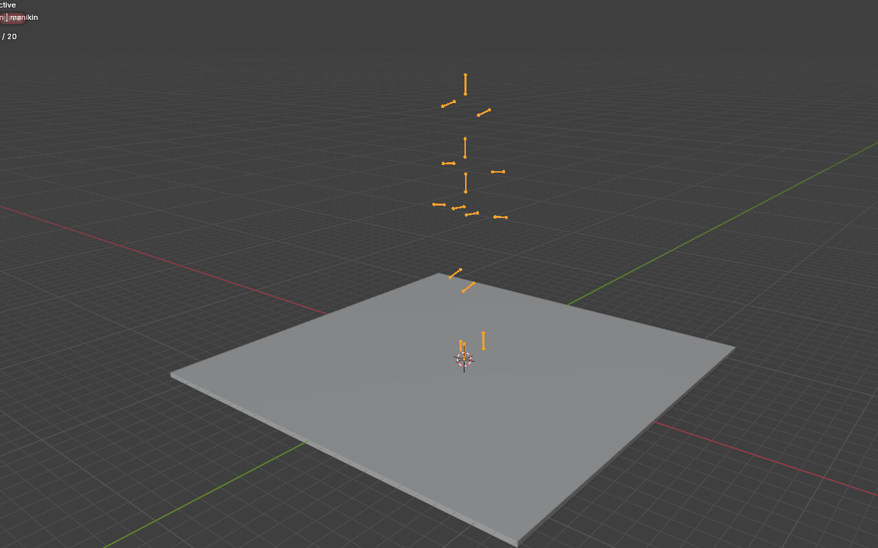

when i assign markers to my bones it does not work, using a preset asset from the plug-in’s menu shows this

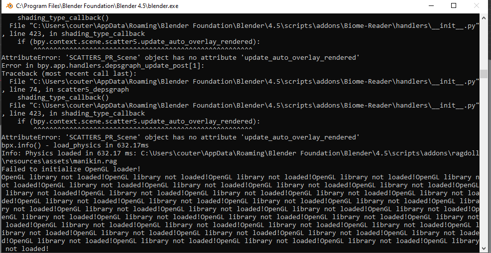

heres the scree of my System Console after opening Manikin asset in an empty scene

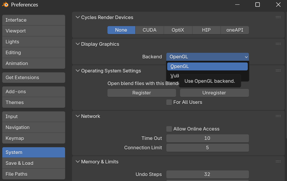

And thanks for reaching out. This is a simple one, just go Preferences and change display backend to OpenGL. Ragdoll currently only supports OpenGL.
oh thanks a lot! that worked :smiley:
