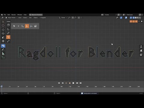

Ragdoll for Blender 1.0
It’s out. :slight_smile:
Ragdoll for Blender is now stable and suitable for production work, homemade shortfilms, fooling around, you name it.
Enjoy a little collage of Ragdoll footage, intended for our new Blender audience (Maya users may have already seen some of this :blush:)
Also enjoy the new website design, now accommodating for both Blender and Maya, and the forthcoming Ragdoll SDK, take a look!
Enjoy, and let us know if you run into any issues! :partying_face:
