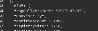

Physics exporter is years ahead of its time!
Just noticed :slight_smile:
Oh dear, we can confirm this. This may have an effect on loading this file in a newer version of Ragdoll, as it would attempt to perform an upgrade between the version in the file and version installed.
Investigating, thanks for reporting it.
Just shared it as a joke cause of the headline :smiley: But if it leads to a bug fix, even better!
New version is up, thanks again for reporting it!
For files saved before this, if it becomes a problem, it is safe to simply change the version inside of the exported .rag file to 2025.09.18, that’s what it should have said and will result in proper upgrading of the file in even newer versions.
