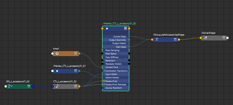

When I import this file all rMarkers that belong to the secondary rGroup have lost their parent marker connection:

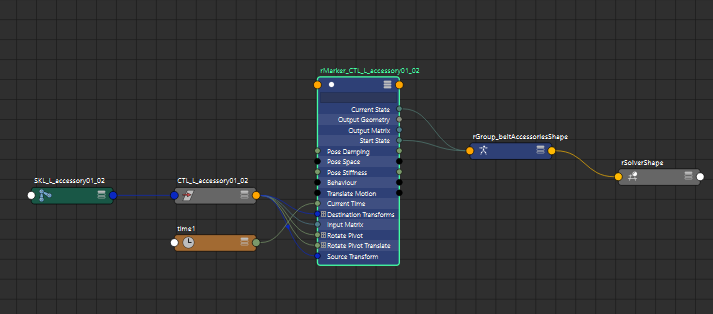

However, if I export via the ragdoll UI, when I import this file the parent marker connection remains in-tact.
