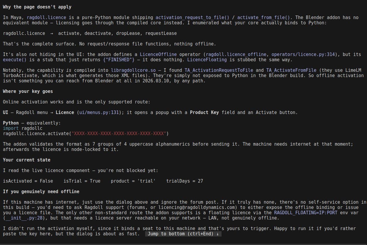

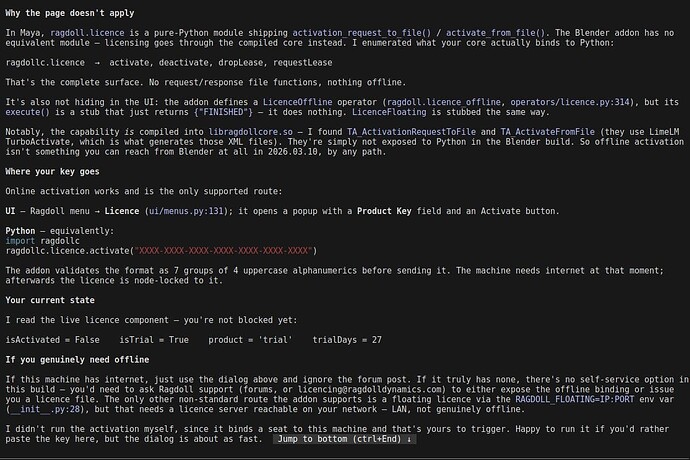

Hello!
Is there any way that could be extended for Blender? We were unfortunately unable to activate the studio license without an internet connection.
Appreciate the help!
