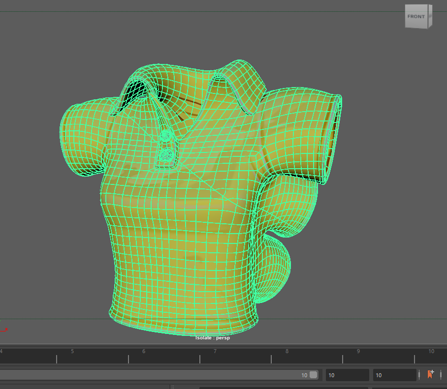

Multicut shape effecting actul geo
for some reason when i cut the shape it effects the geo on my actul mesh slowing it down MASSIVLIY vould anyone help

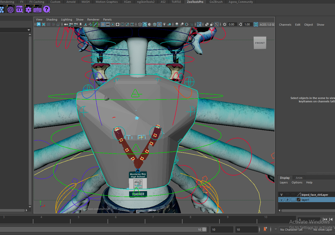

Most likely the geometry is deforming and history is preserved, causing Ragdoll to re-compute the collision geometry each frame.
Either:
  1. Make a duplicate first, just for Ragdoll, and split that
  2. Or see the Replace Mesh option for not preserving history. You can always Replace Mesh again to update it.

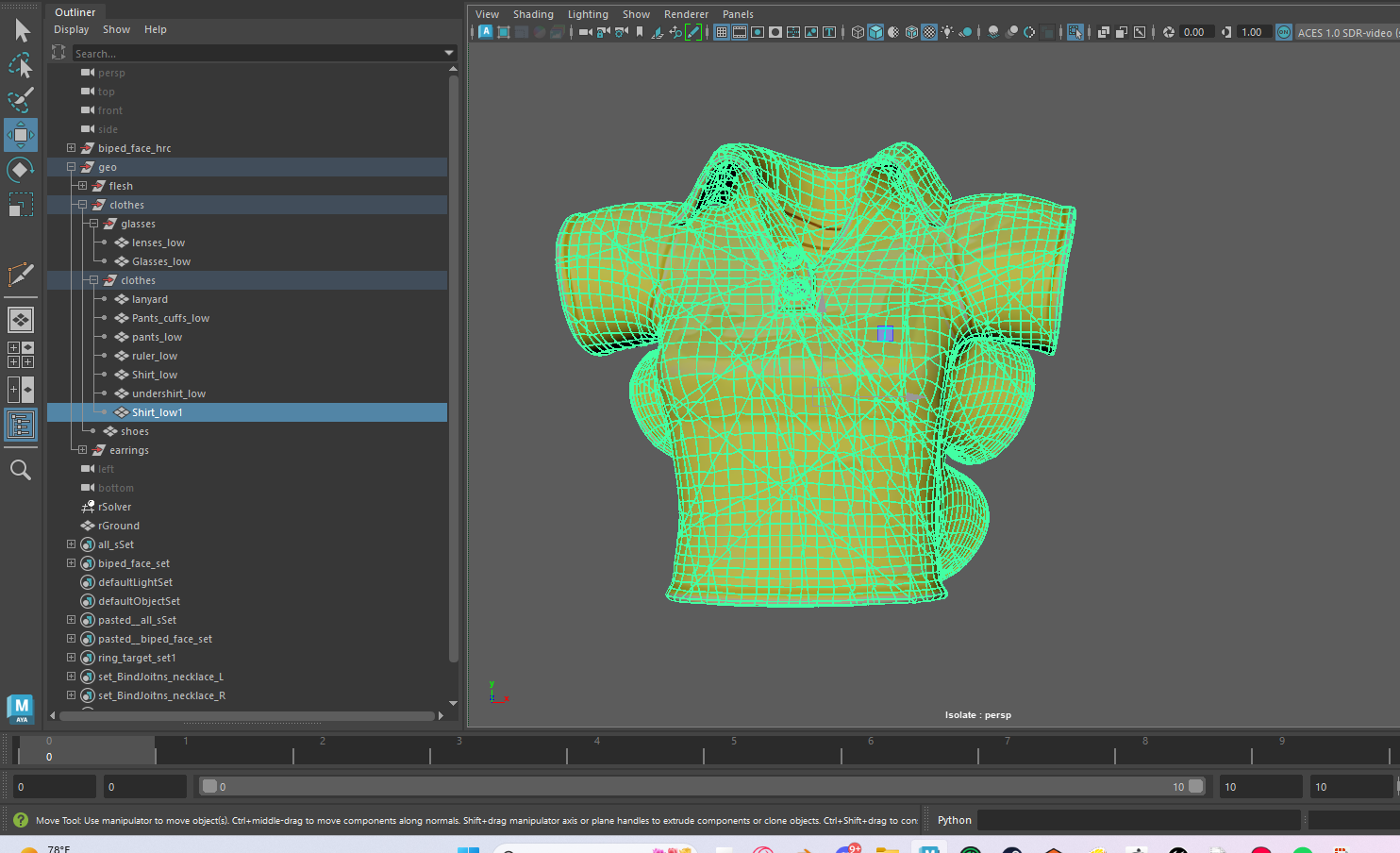

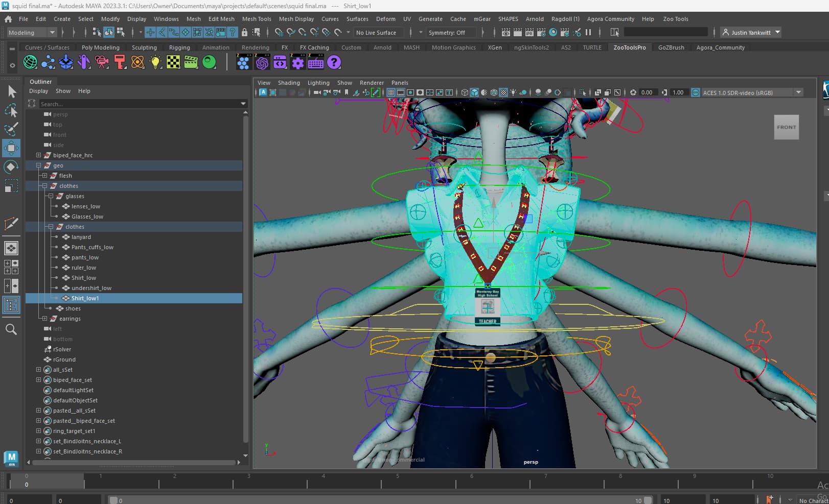

last question how do i connct the the shape that i made by cutting to the actuel geo that i will use?
trying to get this
on to this
wait nevermind! got it
