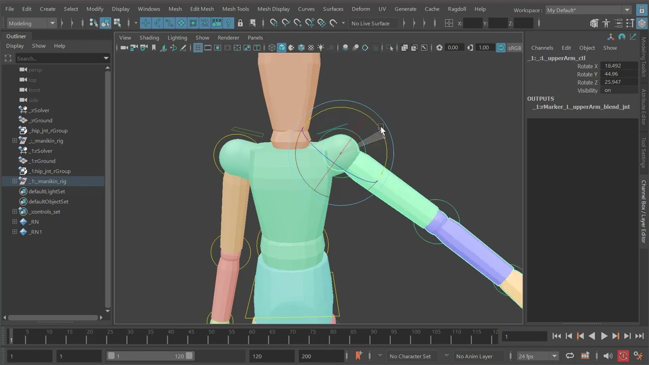

As per the latest tutorials, the Markers are assigned to the joints, in this case only the spine up and through each arm. I’ve tried this with and without limits applied and so far nothing I do works. Cache is cleared, there’s only one animation layer AND, the best part, I’m only ‘Live’ animating the left arm yet the right arm get’s an errant pose applied to it as well when I hit ‘Transfer’ (circled in green). As you can see, the Markers are in the intended pose, and the joints are clearly nowhere near them.
Markers were not created in the characters T-Pose, but rather in an already existing animation, so I thought perhaps that was a potential reason?
All joints with Markers are Retargeted to their respective control. I’ve able to successfully record Ragdoll onto the control rig.
Tried a zeroed out T-Pose of the character and the same thing happens, so clearly there is something wrong with the rig/joints, but what that is is a mystery. That’s what will help here if we can discern what a ‘Ragdoll legal’ skeleton looks like.
EDIT: Also assigned Markers to the Controls (instead of the joints with retargeting) to see if that made any difference…same issue.
