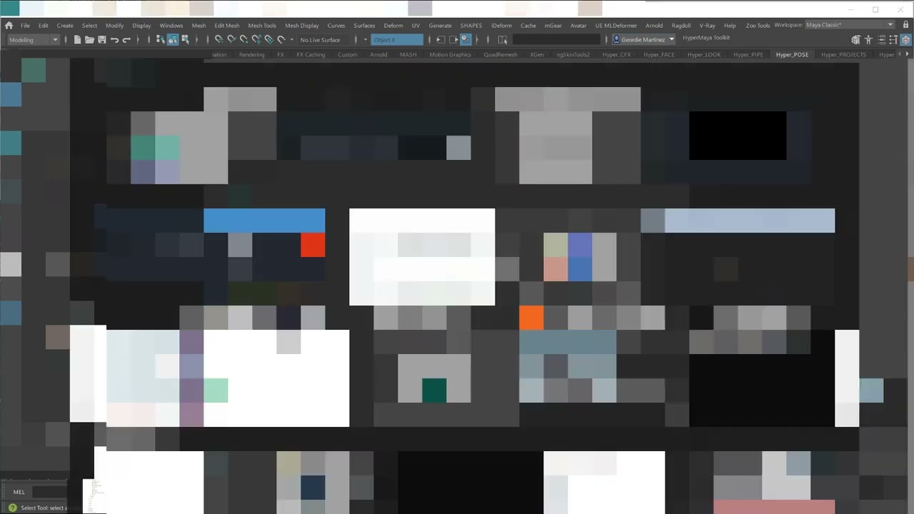

Hey all,
For some reason my setup that is working in one Maya session as Unlimited reverts back to Personal Complete when I open another Maya. Any help or suggestions would be appreciated. I am going to export physics and reimport. But that doesn’t take the solver settings along with it.
I am able to Export Physics, reopen in the other Maya and Import Physics. But that is the only way.
