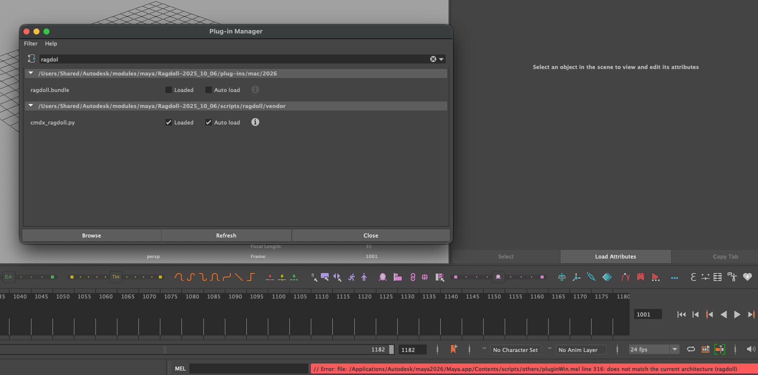

Hello, I struggle installing Ragdoll on Mac M2 for Maya 2026.3.2.
I downloaded the 2026 installer of Ragdoll, in the folders there seem to be only Linux and Windows folders. Not sure if there is missing something + I can’t access the prior Ragdoll Versions on the Website to test other versions. I am sadly rarely new to Mac. I appreciate any kind of help! I hope I didn’t paste it in some wrong folder but I get this message below.
Cause Maya seems to find it BUT -
I got the following error message:
// Error: file: /Applications/Autodesk/maya2026/Maya.app/Contents/scripts/others/pluginWin.mel line 316: does not match the current architecture (ragdoll)
Thanks for reporting this Nina, investigating now.
Turns out it the MacOS link pointed to the Linux release.
We’ve updated this now, please try downloading again. This installer should be much simpler than the one you found. :slight_smile:
Thanks - It worked! Awesome :slight_smile:
