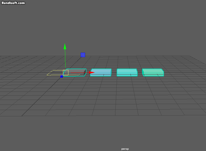

I already have a nice soft animation, and I might add some collisions or reduce rotate stiffness.
But it loses the original feel,
Any tips to keep it close to the original?
Hi @0724bookman, welcome to the forums! ![]()
Try a combination of:
- Increase
Rotate Stiffness, either on each Marker or the group they belong to - Decrease
Rotate Damping
Stiffness will try and stick closer to your animation, whereas Damping will try and prevent motion from happening. Less prevention and stronger association leads to a closer approximation of your animation.
