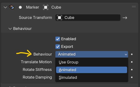

So basically you jsut…:
  1. Assign marker to other objects you want to collide with. And,
  2. If you want them to not moving around, or following your keyframe 100%, try changing marker Behaviour to be "Animated".
Hope this helps.
No it is not the same question, but thank you so much this helps a lot!
