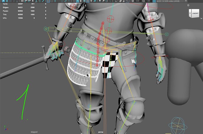

Protection on the hips, it is assembled from several elements. Screenshot 1
I need the protection to collide with the legs, the chain mail(checkerboard material) and a belt strap.

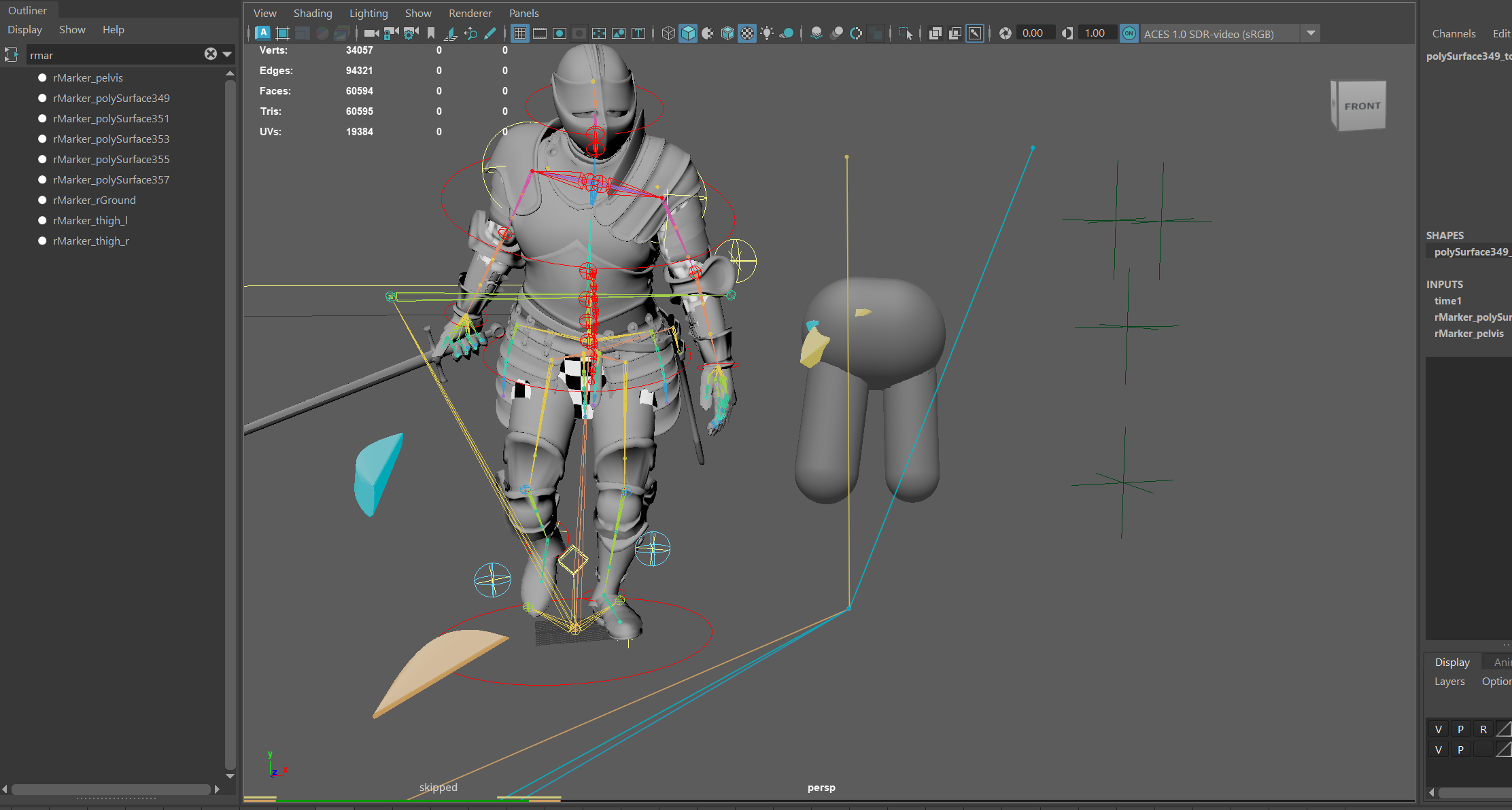

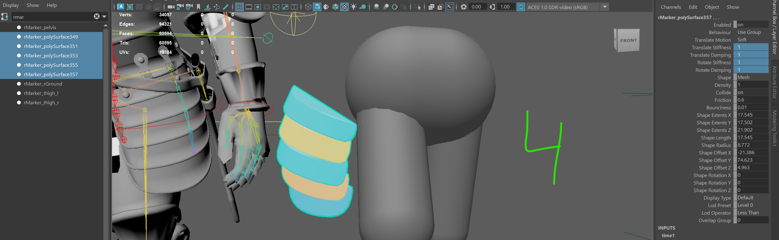

I know that there are 2 settings, these are Animated and Simulation, and I realized that if the legs are not simulated, then I choose Animated, I created capsules from joint, and the protection itself has an unusual shape, so I created it through geometry. Screenshot 2

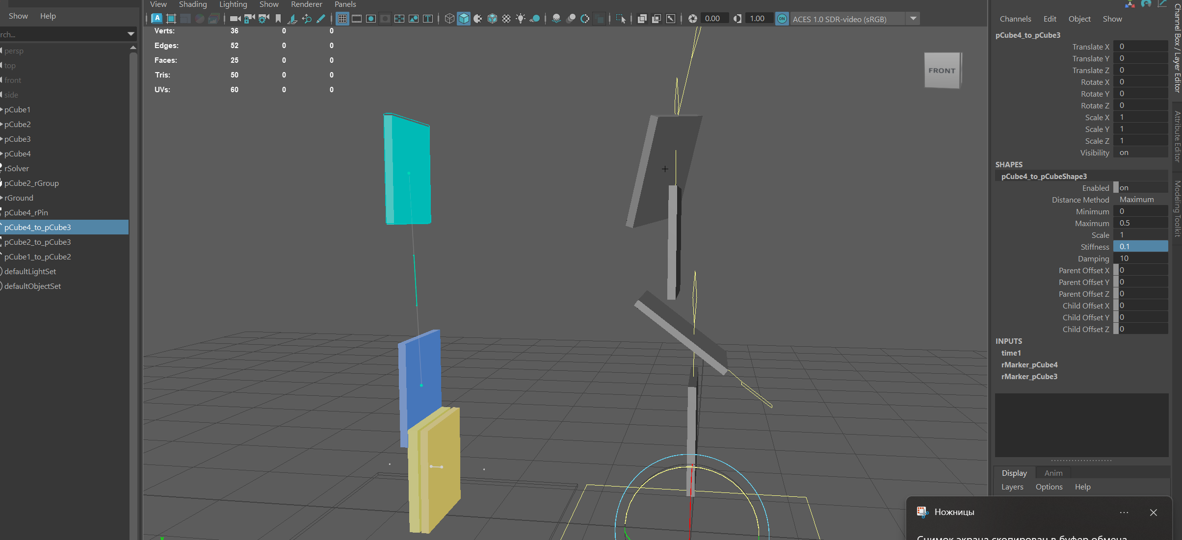

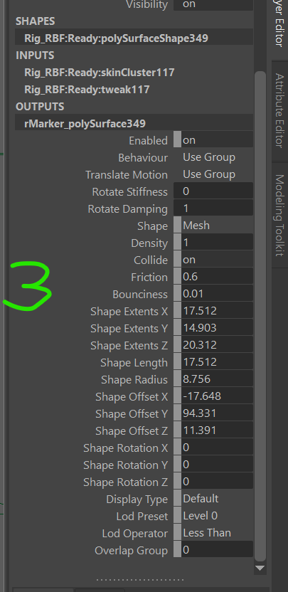

  1. The question about the settings is whether I understand correctly that they now look like this. Screenshot 3. Where do I have to select Translate Motion in Soft mode to adjust the mesh to follow the original animation and turn the Dampind and Stiffness settings there?

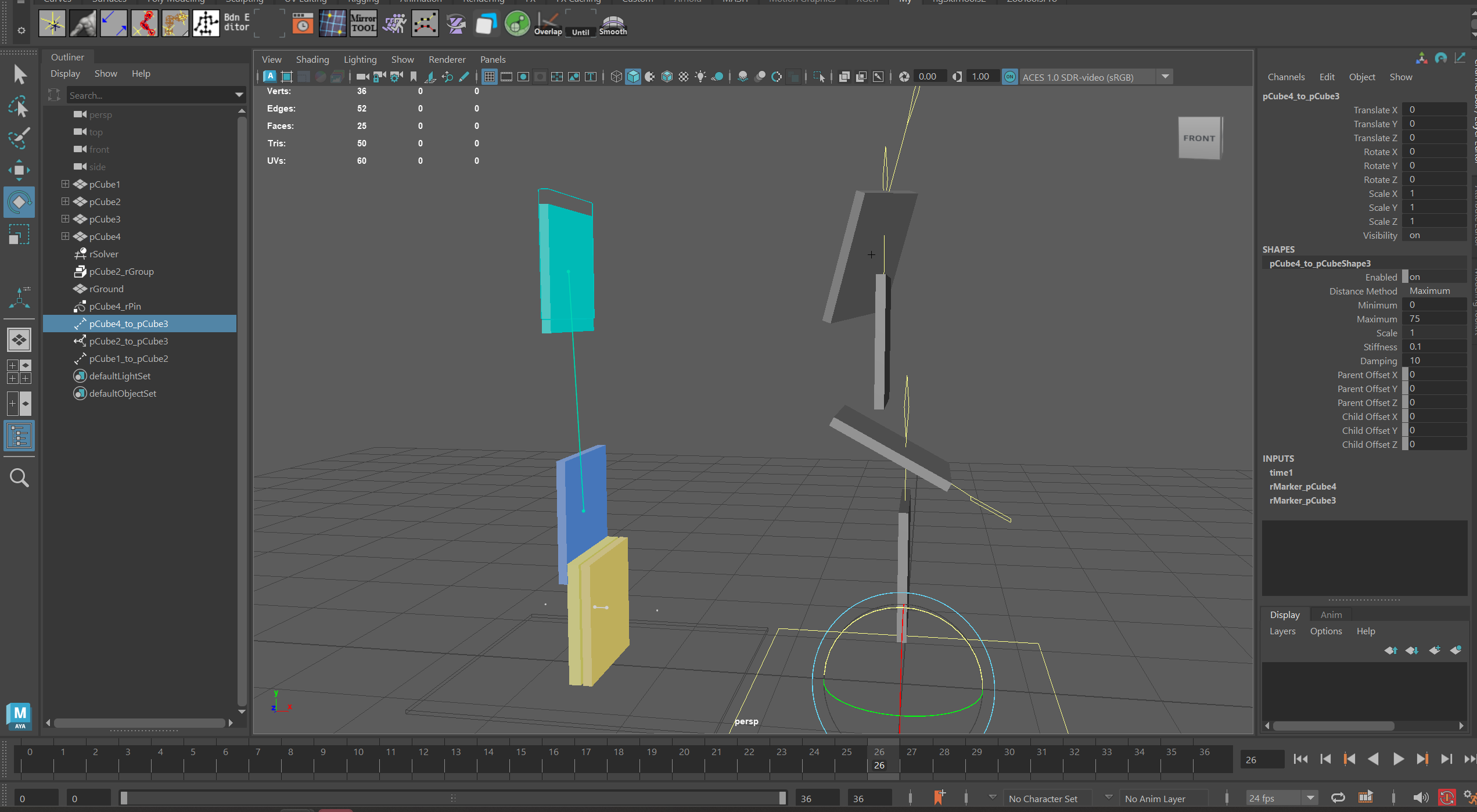

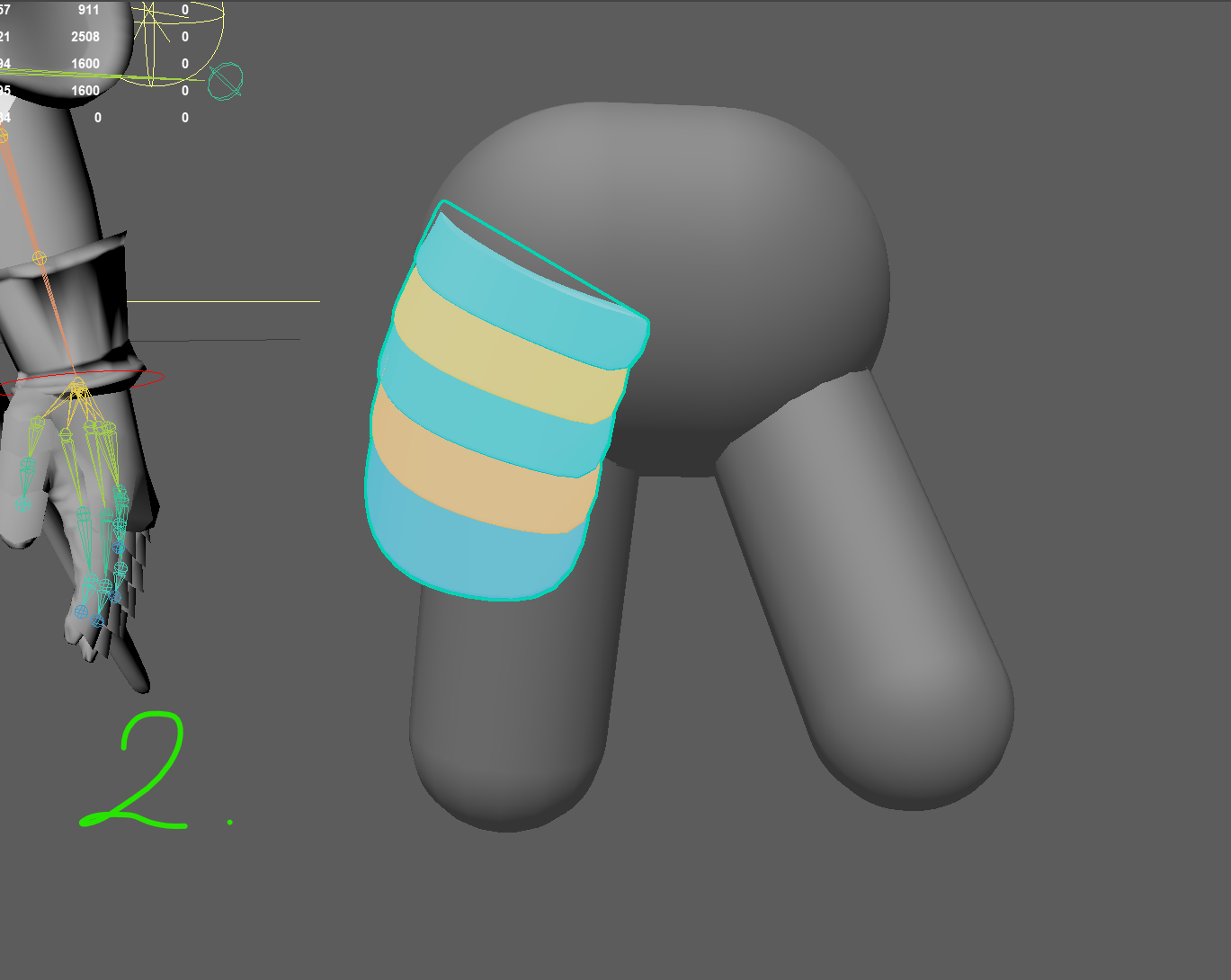

  3. When I select the elements I need, it’s worth turning on the animation that happens. Screenshot 4. These parts fly away on their own, even with these settings, I tried to fix them via Weld, but nothing helped me, how can I solve this problem?

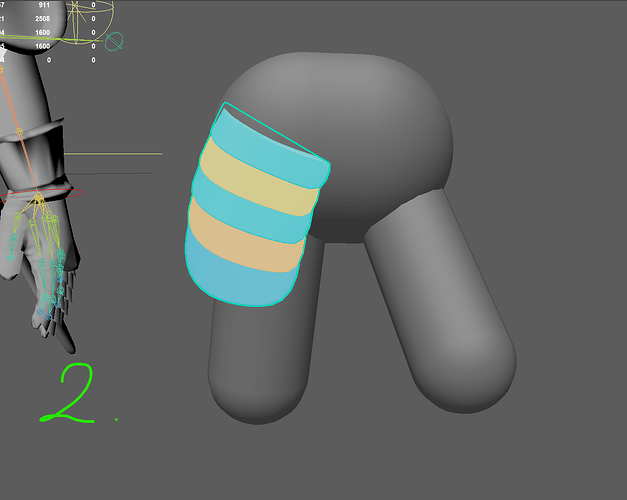

  4. Also, if I apply Weld and attach the main protection to Pelvis, then this happens. *
*. And then I don’t understand how to solve this problem, I tried to select all the security features and disable Collision, but it didn’t help me.

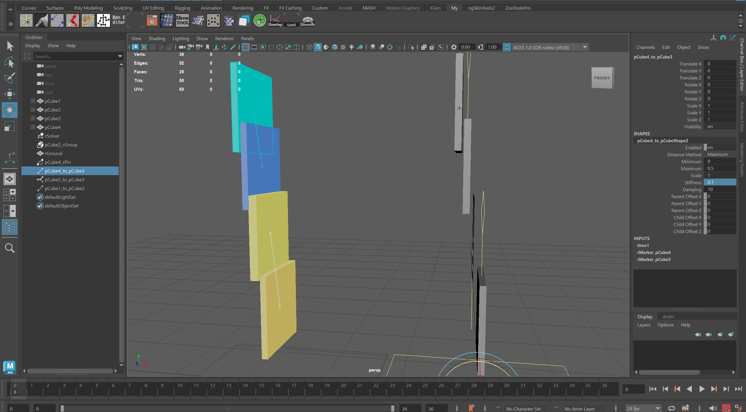

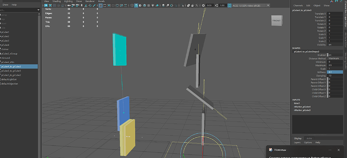

  1. can I quickly control the size and position of Distance?
  2. In your scene, your character moves very fast, but in my video
    Because I want to try adding distance today, as I understand it, to limit the movement of the plates.
And I don’t understand how the distance works, I saw in training that there is a minimum position and
a maximum, but no matter what I choose, it turns out that nothing works, when using weld, I see that
the mesh is fixed to the parent, but that’s not it.
When I enter -1 in Stiffness, it works, but with a value of 0 and +++ nothing happens.

Here’s a short primer for working with the Distance Constraint, notice how the parent and child offsets control the location of the object where a distance is being constrained.
For your usecase, it’s safe to ignore the Distance Method and stick with the default. The default will try and maintain the distance from where they start.
The version in my videos are from the latest Early Access version of Ragdoll, in previous versions, the stiffness may depend on the size/mass of the object. Try a much larger value, such as 10,000 or 100,000. A value of -1 means “infinite”.
