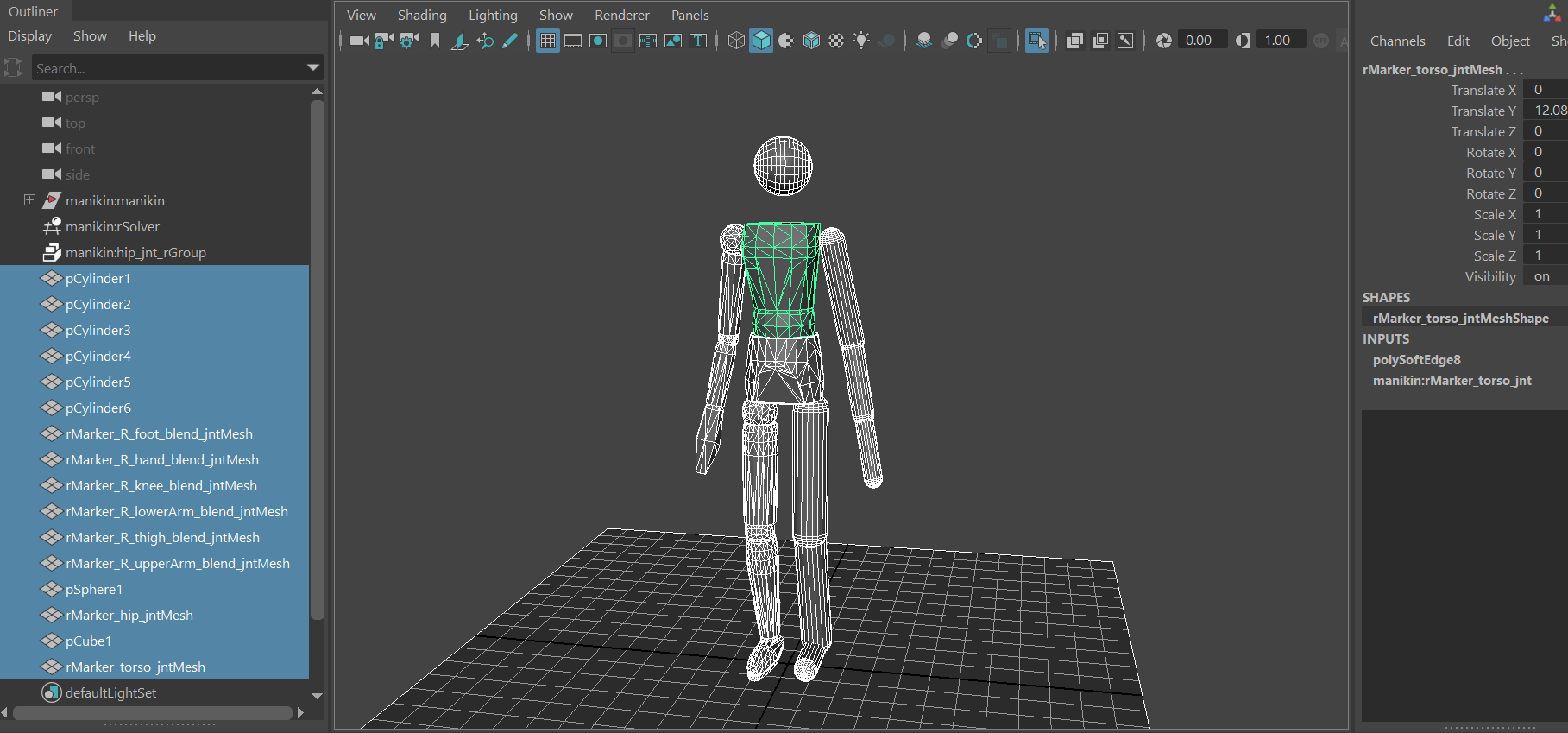

  1. Ragdoll → Select → Markers
  2. Ragdoll → Utilities → Convert to Mesh
It will generate Maya geometry of whatever Ragdoll has got to work with under the hood.
These can be constrained to your character and baked out as Alembic, for a low-poly version that aligns exactly what what Ragdoll used to simulate.
