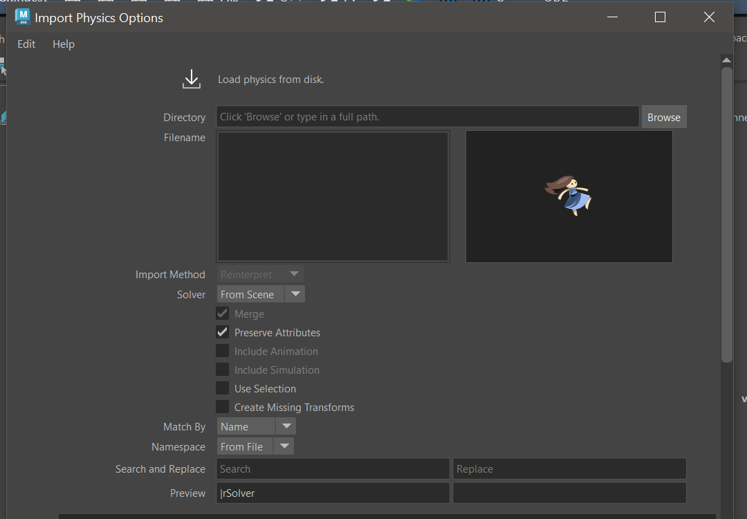

The export isn’t designed to filter what goes out; it always exports everything, such that you can then filter what goes in instead, via the various filters in the Import Physics dialog.
If you wanted to limit what goes out, one option then would be to post-process the JSON produced by the export command.
