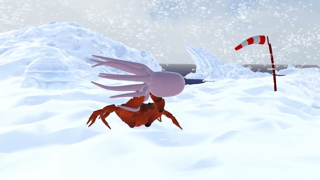

A little update:
I would like to present a sequence of scenes where crabby saves the little octopus from the chef, then they go to a journey and cross all kinds of places and environments and at the end they say goodbye to each other in the ocean.
Here is my kitchen shot. I tried to make some sense of it and I made a little environment for it.
And there is all my bananas :smiley:
I have a lot of fun with the cages and the bananas interactions.
I animate the bunch of bananas stiffness here and there.
Here is a shot in which I found a lot of fun :smiley:
Now the Octopus carry the crabby over a dangerous place.
I’m planning a lava flow there, and where is blow them there a little heat blast, with something very simple effect.
I use a lot of distance constraints and the new attach constraints for the carrying.
I pinned the grasping arms and animate the pins and the stiffnesses.
I animated the Octopus root with some ultra basic animation, and all other things is the ragdoll.
For the final form, I plan to simply fill in the background and the environment, but all my shots will be viewport renders, and I will cut them together.

For the chopstick at the beginning, is the claw Kinematic by any chance? I expect you’d be able to squeeez some more realism out of it by either Distance Constraining the claw to both chopsticks, such that they are free to rotate around that axis, or reparent the claw to one of the kinematic chopsticks, such that you can give it a limit that allows rotation only around one axis. Like an elbow.
Alternatively, it’s possible some simple animation could help break that rigidness of the claw as it’s being lifted around.
Other than that, the banana scene looks fantastic, the transition into a walk looks great, the pickup of the octopus and the octopus itself looks great. Five stars mate! :star:

This is pretty frekken cool! Great concept !! Love seeing this come together! The octopus carrying the crab!! Genius !! Notice you have distance constraints keeping the legs attached to the body - interesting concept , have you tried soft transforms to get some stretching between the markers ?
J
Thank you very much!
Yeah I use distance constrains, and a little custom 0, stiffness, ∼0.4.
I didn’t know that option, how can I set the soft tranforms up?
Also called “Soft Joints” and “Translate Motion”.
Have a look here.
