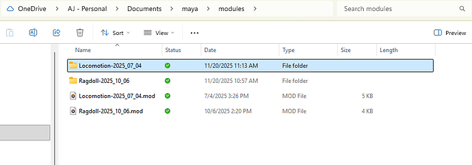

I get this error when I install the ragdoll plugin. Im trying to use locomotion in maya 2026 and cant get it to run.
Ive tried copying the locomotion folders and files to my plugins and scripts folder in documents and its not helping.
here are the errors in the script editor.
Successfully installed Ragdoll menu from plug-in load.
// Error: line 1: Plug-in, “locomotion”, was not found on MAYA_PLUG_IN_PATH.
// Error: Failed to load locomotion
// Warning: line 1: waitCursor stack empty
Any help in fixing this issue would be greatly appreciated. I bet im doing something dumb or missing something obvious.
I was searching through the forums and learned that locomotion is not supported in maya 2026 :frowning:
Any updates when this will be supported?
Thanks!
Hi @SharpKnight, welcome to the forums! :partying_face:
It is indeed not yet supported. Support will likely happen after Ragdoll 4.0 is out and about.
