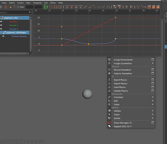

Animated the rotate damping on marker and translate damping off the pin. Pin is parented to hand joint.

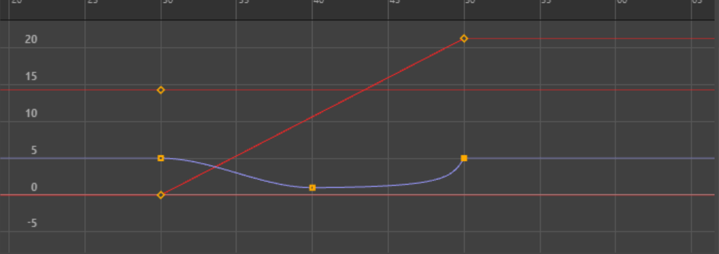

That example is simmed, nothing handmade. Only pin is animated like so:

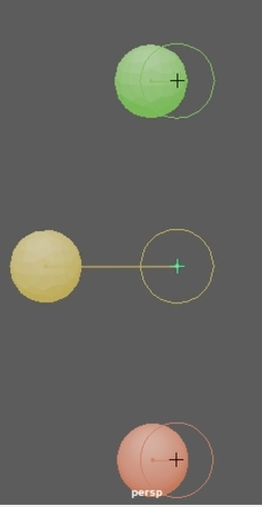

Made 2 examples now with different stiffness and damping for the default behaviour spheres.
Lowest red sphere in both videos is the requested behaviour. It follows pin animation close like the stiff green sphere, but eases in and out of harsh curves like the loose yellow sphere.
Pay close attention to how its combining stiff and loose marker distance to pin

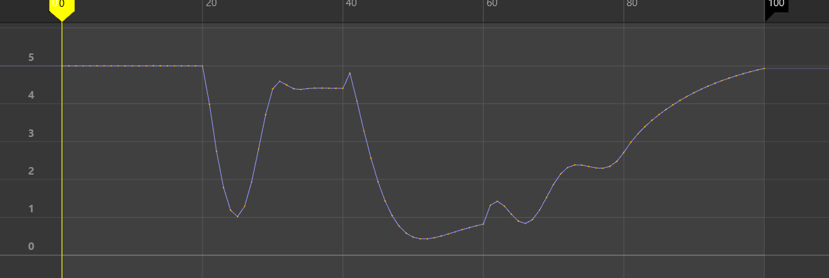

Great, this is the trajectory for each of the spheres.
Your request is for Ragdoll to produce the same erratic behaviour of the one at the bottom, as opposed to the smooth motion of the two above? And you expect this to be automatically achieved by mapping distance between target and object to Translate Damping?
Here’s what that would look like.

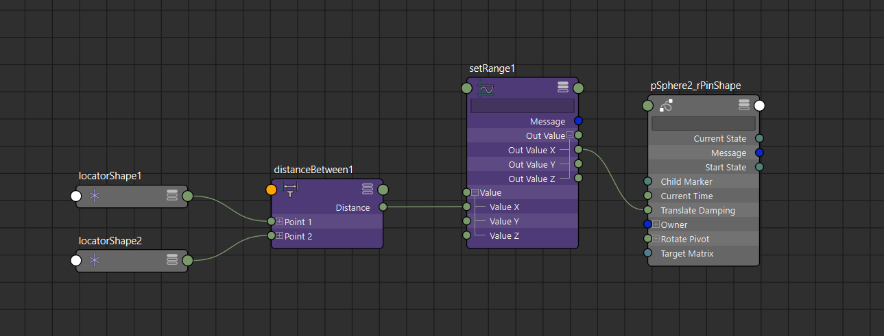

In this prototype, the distance is mapped to values between 0.3 and 5.0, the same as the bottom example.
example_distance.ma (281.8 KB)
To reproduce:
  1. Run the simulation once
  2. Connect the output of setRange.x to Translate Damping
  3. Run the simulation again
The second round will use the distance from the first simulation, just like it would in real-time if such a feature were to be implemented.

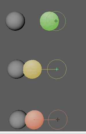

The red one looks different because the damping is hand-animated, Ragdoll can’t do that. The proposal is for damping to be relative the distance between object and target, which the author expects should look like this:
But in reality would look like this (from the above example file):
With this in mind, I expect this is unachievable by Ragdoll and better left to hand-keyframing. Thanks for the proposal.
