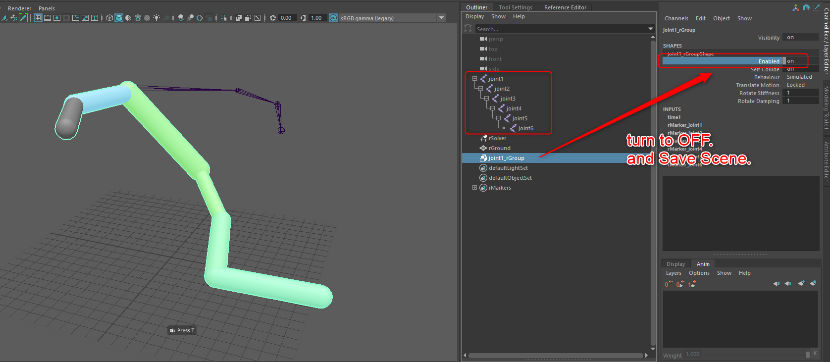

- Save the scene with the attr of marker group “enable” set to “OFF”.

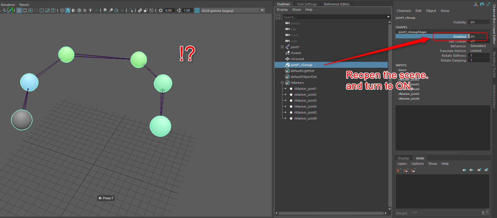

2.Close the scene. - Reopen the scene.
- Turn “enable” of the marker group attr to “ON”.

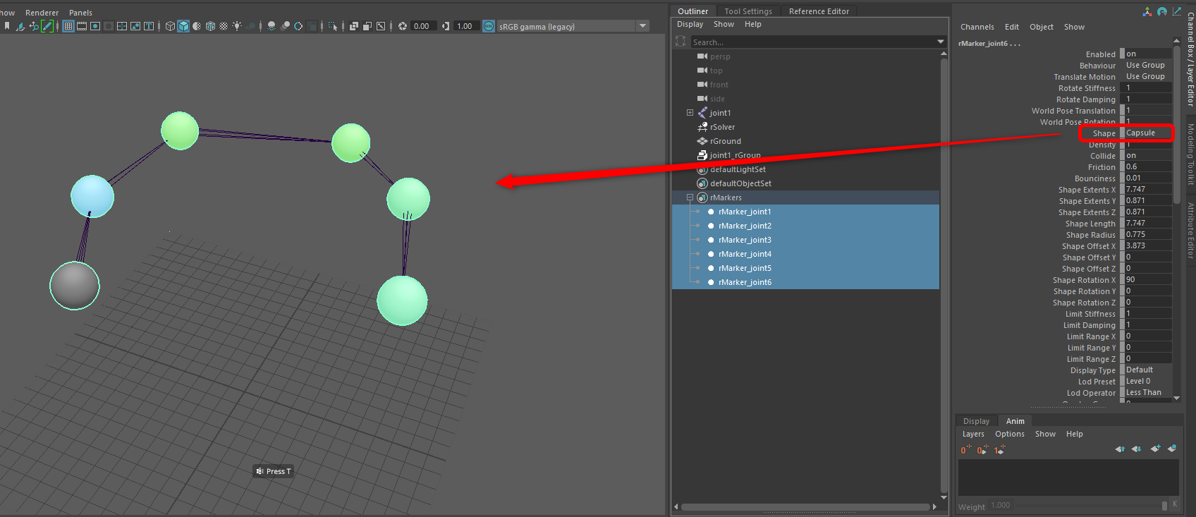

- You can see the shape of the marker becomes a “ball”.
Annoyingly, the shape attribute is still capsule, it’s not sphere.
However, the actual shape is a ball. So it’s not an easy fix.
I’ve verified that this issue reproduces with a very simple bones-only scene.
So I don’t think it’s a compatibility issue with our rig system.
