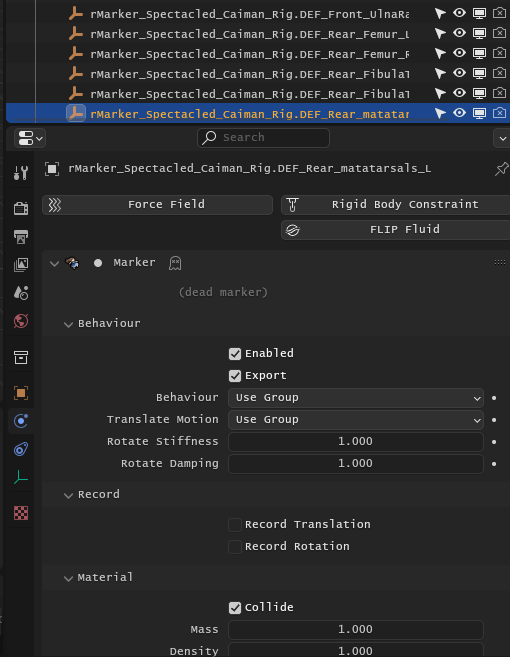

Yeah, its possible that i missed something tho. Also i just opened the file and for some reason all of the markers are dead
I think ill just redo the setup for good measure
By “dead”, you mean they are no longer visible in viewport? Did you see any error messages?

But cannot see any “dead” marker by saving the same file and reopen it.
glad you found it! not sure what happened to be honest
after i wrote the message here yesterday i just closed the file - today i opened and they are dead
Ah, I see!
Yeah that “dead marker” means the bone or object that the marker was originally assigned to, has been deleted.
Maybe those markers were just residue from previous rig redo? Or for some reason, the entire rig was not loaded or gone?

Since your workflow involves many rig changes, and lots of “dead marker” were left in your scene. To make things cleaner, we added a new operator ragdoll.delete for deleting object/bone and their assigned markers in one undo step.
Let’s see if using this custom operator for object/bone deletion helps. Please try assign a hotkey for this ragdoll.delete operator, or just assign Blender’s default object deleting hotkey X to it.
For example, try replacing Outliner > Delete operator.
And Object Mode > Delete
And Armature > Delete, for bone delete or dissolve.
Once done, you should see something like this.
