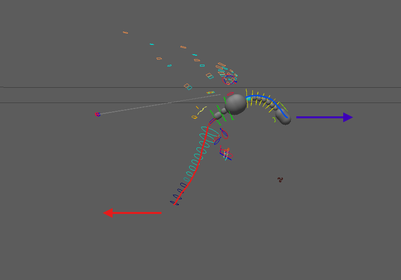

I’m having a dragon fall to it’s death, and I want the air to push the head in the X+, and the tail chain to be pushed into X-, so that they don’t coil into themselves as they fall. I need to set the 2 groups to have 2 unique wind influences.

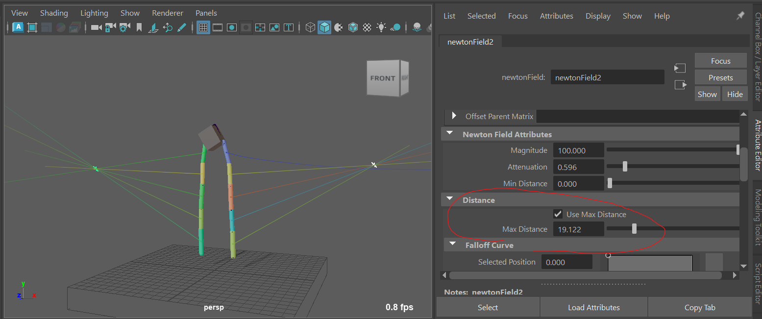

Not possible for now. The force fields are per-solver only.
But have a look and try tweaking “Max Distance” to attract/pull the head and tail to different directions.
Nice, that’s a decent solution in the mean-time. Thank you.
